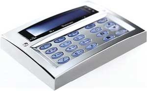

sixwheeledbeast Posted March 9, 2015 Share Posted March 9, 2015 The kits can be cost effective if you don't mind the stuff that comes with it. I am not keen on the Texecom sensors personally, so would buy the panel, keypad and tags separately. Us in the trade here will buy from a wholesalers or trade counter, so maybe we are not the best to ask and your favourite search engine is your friend there. The last picture looks like a flush keypad so maybe avoid if your not planning on chiseling a huge hole in the wall. Link to comment https://www.thesecurityinstaller.co.uk/community/topic/38176-veritas-excel-new-install-eol-question/page/13/#findComment-412821 Share on other sites More sharing options...
Mark02 Posted March 9, 2015 Author Share Posted March 9, 2015 The kits can be cost effective if you don't mind the stuff that comes with it. I am not keen on the Texecom sensors personally, so would buy the panel, keypad and tags separately. Us in the trade here will buy from a wholesalers or trade counter, so maybe we are not the best to ask and your favourite search engine is your friend there. The last picture looks like a flush keypad so maybe avoid if your not planning on chiseling a huge hole in the wall. No it's a surface mount. I did actually work out they do either and wondered how much work would be involved fitting a flush mount. I had visions of waving at the neighbours before filling the whole with the keypad LOL This is a better pic of the one above Link to comment https://www.thesecurityinstaller.co.uk/community/topic/38176-veritas-excel-new-install-eol-question/page/13/#findComment-412828 Share on other sites More sharing options...
