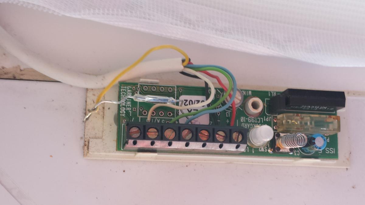

andy82 Posted August 26, 2014 Share Posted August 26, 2014 Been meaning to post this for a while, I went to a job fitted by a company we bought out to remove a load of vibration detectors ready for the customer to have new windows/doors fitted. Anyway as im going around removing them all I get to the rear door that the customer informs me that the detector is a vibration and contact at first I didnt think much of it but was a bit surprised as I had never seen a Gardtec Shockguard with a built in contact so I open it up to find this! Link to comment https://www.thesecurityinstaller.co.uk/community/topic/37278-shockingly-poor-homemade-vipercontact/ Share on other sites More sharing options...
Amps Posted August 26, 2014 Share Posted August 26, 2014 Is it graded? Link to comment https://www.thesecurityinstaller.co.uk/community/topic/37278-shockingly-poor-homemade-vipercontact/#findComment-396984 Share on other sites More sharing options...

andy82 Posted August 26, 2014 Author Share Posted August 26, 2014 Is it graded? No Link to comment https://www.thesecurityinstaller.co.uk/community/topic/37278-shockingly-poor-homemade-vipercontact/#findComment-396986 Share on other sites More sharing options...
sixwheeledbeast Posted August 26, 2014 Share Posted August 26, 2014 Amazing the glass reed didn't break while wedging it in there. Link to comment https://www.thesecurityinstaller.co.uk/community/topic/37278-shockingly-poor-homemade-vipercontact/#findComment-396987 Share on other sites More sharing options...
norman Posted August 26, 2014 Share Posted August 26, 2014 Blob of solder and it'd be bob on. Nothing is foolproof to a sufficiently talented fool. Link to comment https://www.thesecurityinstaller.co.uk/community/topic/37278-shockingly-poor-homemade-vipercontact/#findComment-396988 Share on other sites More sharing options...

andy82 Posted August 27, 2014 Author Share Posted August 27, 2014 Will keep this in mind for future installs! It apparently false alarmed quite a lot surprisingly! Link to comment https://www.thesecurityinstaller.co.uk/community/topic/37278-shockingly-poor-homemade-vipercontact/#findComment-397205 Share on other sites More sharing options...
datadiffusion Posted August 27, 2014 Share Posted August 27, 2014 What a joke eh. Esp if it was a BS installation how hard would it have been to add a contact beside, or use a viper with built in contact! So, I've decided to take my work back underground.... to stop it falling into the wrong hands Link to comment https://www.thesecurityinstaller.co.uk/community/topic/37278-shockingly-poor-homemade-vipercontact/#findComment-397206 Share on other sites More sharing options...
