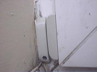

Cubit Posted July 24, 2014 Share Posted July 24, 2014 My actual sensor looks like this: The left hand sensor is wired, the right one isn't Whilst it's a little snug when closing (as the door has expanded slightly), the sensor cases are not at all loose. Any ideas? Thank you so much! No picture but your comment suggests even more so, lid tamper is likely cause. Link to comment https://www.thesecurityinstaller.co.uk/community/topic/37108-euromini-alarm-sensor-problem/page/2/#findComment-391177 Share on other sites More sharing options...
Alice Goody Posted July 24, 2014 Author Share Posted July 24, 2014 No picture but your comment suggests even more so, lid tamper is likely cause. Sorry! Hopefully this will show the picture.... Is this something that you think I could fix? Link to comment https://www.thesecurityinstaller.co.uk/community/topic/37108-euromini-alarm-sensor-problem/page/2/#findComment-391179 Share on other sites More sharing options...
datadiffusion Posted July 24, 2014 Share Posted July 24, 2014 Ah, Elmdene contacts. Yuck. I hate their surface models. If the lids are tight, you'll really have to call someone out who would probably change the contact. We do have members in that area, there is a directory on here or you could use the SSAIB and NSI searches as above. Hope this helps! So, I've decided to take my work back underground.... to stop it falling into the wrong hands Link to comment https://www.thesecurityinstaller.co.uk/community/topic/37108-euromini-alarm-sensor-problem/page/2/#findComment-391181 Share on other sites More sharing options...
norman Posted July 24, 2014 Share Posted July 24, 2014 That also needs realigning. Nothing is foolproof to a sufficiently talented fool. Link to comment https://www.thesecurityinstaller.co.uk/community/topic/37108-euromini-alarm-sensor-problem/page/2/#findComment-391182 Share on other sites More sharing options...
al-yeti Posted July 24, 2014 Share Posted July 24, 2014 That also needs realigning. Yes , they don't work that good fitted that way, and don't have lid tamper must be connection problem, are they all the same comes with a tail and join is act somewhere else? Link to comment https://www.thesecurityinstaller.co.uk/community/topic/37108-euromini-alarm-sensor-problem/page/2/#findComment-391185 Share on other sites More sharing options...
datadiffusion Posted July 24, 2014 Share Posted July 24, 2014 The ones I fitted were switch tampered - http://www.elmdene.co.uk/grade-2-magnetic-plastic-contacts.html So, I've decided to take my work back underground.... to stop it falling into the wrong hands Link to comment https://www.thesecurityinstaller.co.uk/community/topic/37108-euromini-alarm-sensor-problem/page/2/#findComment-391194 Share on other sites More sharing options...
