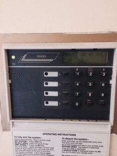

richmondhall Posted April 12, 2014 Share Posted April 12, 2014 Hi new to forum, I have searched but can't find answer on forum - sorry if I have missed it.. I have scantronic 9600, and need to replace the cable but ...how do you remove the front panel of the keypad? to gain access to the back ? No screws visible and reluctant to lever off of case it breaks. Checked the install manual but it doesn't mention... I guess if your installing it it is obvious. Any help gratefully received. Link to comment https://www.thesecurityinstaller.co.uk/community/topic/36514-scantronic-9600-keypad-how-to-remove/ Share on other sites More sharing options...

datadiffusion Posted April 12, 2014 Share Posted April 12, 2014 As I'm sure you're aware the alarm will go off and you will prob need the eng code to reset... So, I've decided to take my work back underground.... to stop it falling into the wrong hands Link to comment https://www.thesecurityinstaller.co.uk/community/topic/36514-scantronic-9600-keypad-how-to-remove/#findComment-376762 Share on other sites More sharing options...
morph Posted April 12, 2014 Share Posted April 12, 2014 not if the cable is knackered........... Link to comment https://www.thesecurityinstaller.co.uk/community/topic/36514-scantronic-9600-keypad-how-to-remove/#findComment-376769 Share on other sites More sharing options...
datadiffusion Posted April 12, 2014 Share Posted April 12, 2014 True - but thought I could see the display working... Of course, could be an old or generic pic So, I've decided to take my work back underground.... to stop it falling into the wrong hands Link to comment https://www.thesecurityinstaller.co.uk/community/topic/36514-scantronic-9600-keypad-how-to-remove/#findComment-376793 Share on other sites More sharing options...
norman Posted April 12, 2014 Share Posted April 12, 2014 Sunday 7th July? Levers from the bottom, slim screwdriver in-between the case parts iirc. Nothing is foolproof to a sufficiently talented fool. Link to comment https://www.thesecurityinstaller.co.uk/community/topic/36514-scantronic-9600-keypad-how-to-remove/#findComment-376794 Share on other sites More sharing options...
