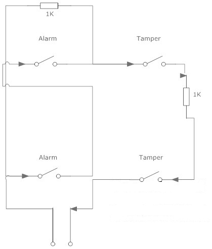

Its possible to make it work but it is really a bad idea.
Its not a simple diagram either.
But if your sure ill know up a diagram later
If you could please knock up adiagram , i am interested in circuitry as to how this works
Thanks
