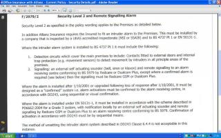

Email from someone at Allianz (different job)
Hi Gill,
In order to put this one to bed, our surveyor has stated that we require confirmation of the following:
  • Is the fault reporting time for loss of the IP path alone within 3 minutes?
  • Has the signalling product been tested and approved under LPS1277?
Sorry but the IP path reporting time is unclear from the alarm specification.
I look forward to receiving your confirmation with regards to the above as soon as possible.
Kind Regards

look at this attachment
That document only says fault reported in x mins.
Not that it would report both paths as failed and thus a confirmed alarm. If it only (as i suspect) sent a primary path failure then upto 24hours later a secondary. You wouldnt get a police response or a confirmed alarm for upto 24 hours.
Its not clear IMO but as the EN standard allows upto 24 hours for this second signal to be reported id say its not 3 mins. If it was it would have to poll both paths at least every 3 mins to know. And i know a dualcom does not do that when both paths are up. You wouldnt be able to use the line for anything else as it would be dialling every 3 mins on the PSTN. If it doesnt then the reciever cant know that both paths are down if they go down together.
