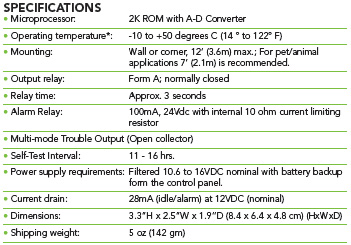

Service Engineer Posted October 17, 2005 Share Posted October 17, 2005 There's only 1 DT i'd recommend and that's the Napco CS100. It will cope well with extremes of temperature, even down to -10. The others may suggest a few more options, but currently this is the only one I know to that works below zero. ........................................................ Dave Partridge (Romec Service Engineer) Link to comment https://www.thesecurityinstaller.co.uk/community/topic/7861-external-wooden-shed/#findComment-72499 Share on other sites More sharing options...

whistle Posted October 18, 2005 Share Posted October 18, 2005 Just noticed on the data sheet dave posted it says "for pet aplication mount at 2.1m" Never thaught these were pet tolerant detectors. do you have to change the lens? Link to comment https://www.thesecurityinstaller.co.uk/community/topic/7861-external-wooden-shed/#findComment-72551 Share on other sites More sharing options...
