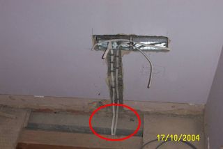

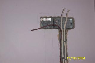

1019641 Posted October 11, 2005 Share Posted October 11, 2005 Nice Intruder install, Just been looking at your other pics, and the re-wire, a bit of a no no Pics Just resized the image Dean Wholey NCC Dean.Wholey@Ntlworld.com Link to comment https://www.thesecurityinstaller.co.uk/community/topic/7754-a-massive-thank-you/page/3/#findComment-71703 Share on other sites More sharing options...
Guest Posted October 11, 2005 Share Posted October 11, 2005 Er, oh dear! Maybe you should have got someone in to the job properly after all. Link to comment https://www.thesecurityinstaller.co.uk/community/topic/7754-a-massive-thank-you/page/3/#findComment-71706 Share on other sites More sharing options...
Guest Chewie Posted October 11, 2005 Share Posted October 11, 2005 Pictures as clear as a bell, how many people seperate the coax from the mains going into the set, look behind most sets and its like spagetti junction. Link to comment https://www.thesecurityinstaller.co.uk/community/topic/7754-a-massive-thank-you/page/3/#findComment-71720 Share on other sites More sharing options...
Guest Posted October 11, 2005 Share Posted October 11, 2005 Consider the point missed entirely. How do you explain the lack of grommets to boxes then? As I said before, I've seen worse, but that doesn't make it right. Link to comment https://www.thesecurityinstaller.co.uk/community/topic/7754-a-massive-thank-you/page/3/#findComment-71724 Share on other sites More sharing options...
Adi Posted October 11, 2005 Share Posted October 11, 2005 There are rules and regulations and they are there for a reason. Part P was rushed in to combat that **** and a lot of poor sods lost there jobs and lively hood. Im all for part P but not the way it has been brought in and the lack of advertising the government has done. I really can't be ar**** with it anymore. Link to comment https://www.thesecurityinstaller.co.uk/community/topic/7754-a-massive-thank-you/page/3/#findComment-71727 Share on other sites More sharing options...
Guest Chewie Posted October 11, 2005 Share Posted October 11, 2005 I find gromets to be more trouble than they are worth, I have used them in the past. Upon filling the chasing, I make sure that it squeezes right into the socket box hole. The cable is completely encased with no chance of movement or touching the sharp edge of the hole. Link to comment https://www.thesecurityinstaller.co.uk/community/topic/7754-a-massive-thank-you/page/3/#findComment-71729 Share on other sites More sharing options...
Guest Posted October 11, 2005 Share Posted October 11, 2005 Doesn't make any difference how you bodged it in, it's still wrong. I have used millions of grommets and getting 2 2.5mm cables in one is no bother whatsoever. You have had a few to do and decided to rough it in instead, you've even used 1 hole per cable so you have absolutely no excuses whatsoever. Link to comment https://www.thesecurityinstaller.co.uk/community/topic/7754-a-massive-thank-you/page/3/#findComment-71735 Share on other sites More sharing options...
Brian c Posted October 11, 2005 Share Posted October 11, 2005 I find gromets to be more trouble than they are worth, They're also there to stop cables stripping/nicking when you are pulling them through the holes, not just for when they're in. Another no-no...... I guess you'll have to router the underside of the floorboards If you don't know......ask. Link to comment https://www.thesecurityinstaller.co.uk/community/topic/7754-a-massive-thank-you/page/3/#findComment-71736 Share on other sites More sharing options...
Guest Chewie Posted October 11, 2005 Share Posted October 11, 2005 If you look closely that is concrete and I chased a grove out for the cables to sit in. If your careful and not a ham fisted leccy you dont nick the cables Link to comment https://www.thesecurityinstaller.co.uk/community/topic/7754-a-massive-thank-you/page/3/#findComment-71738 Share on other sites More sharing options...
