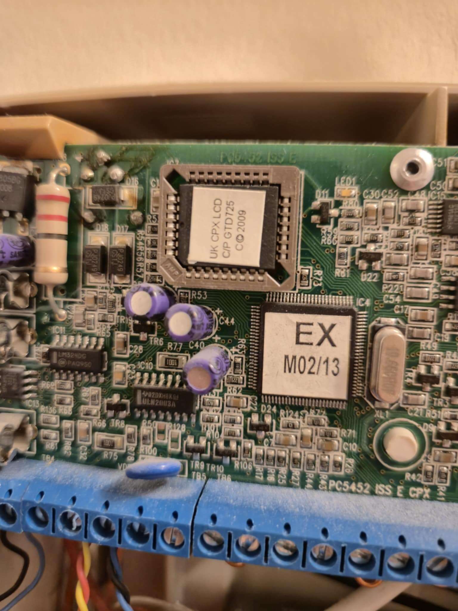

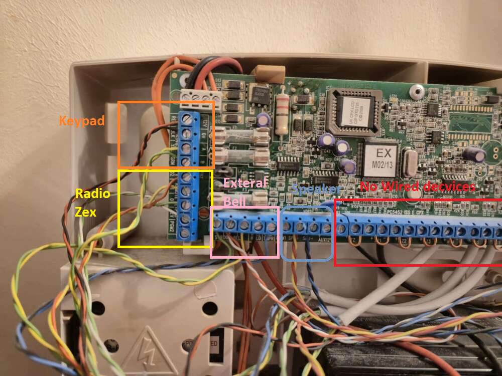

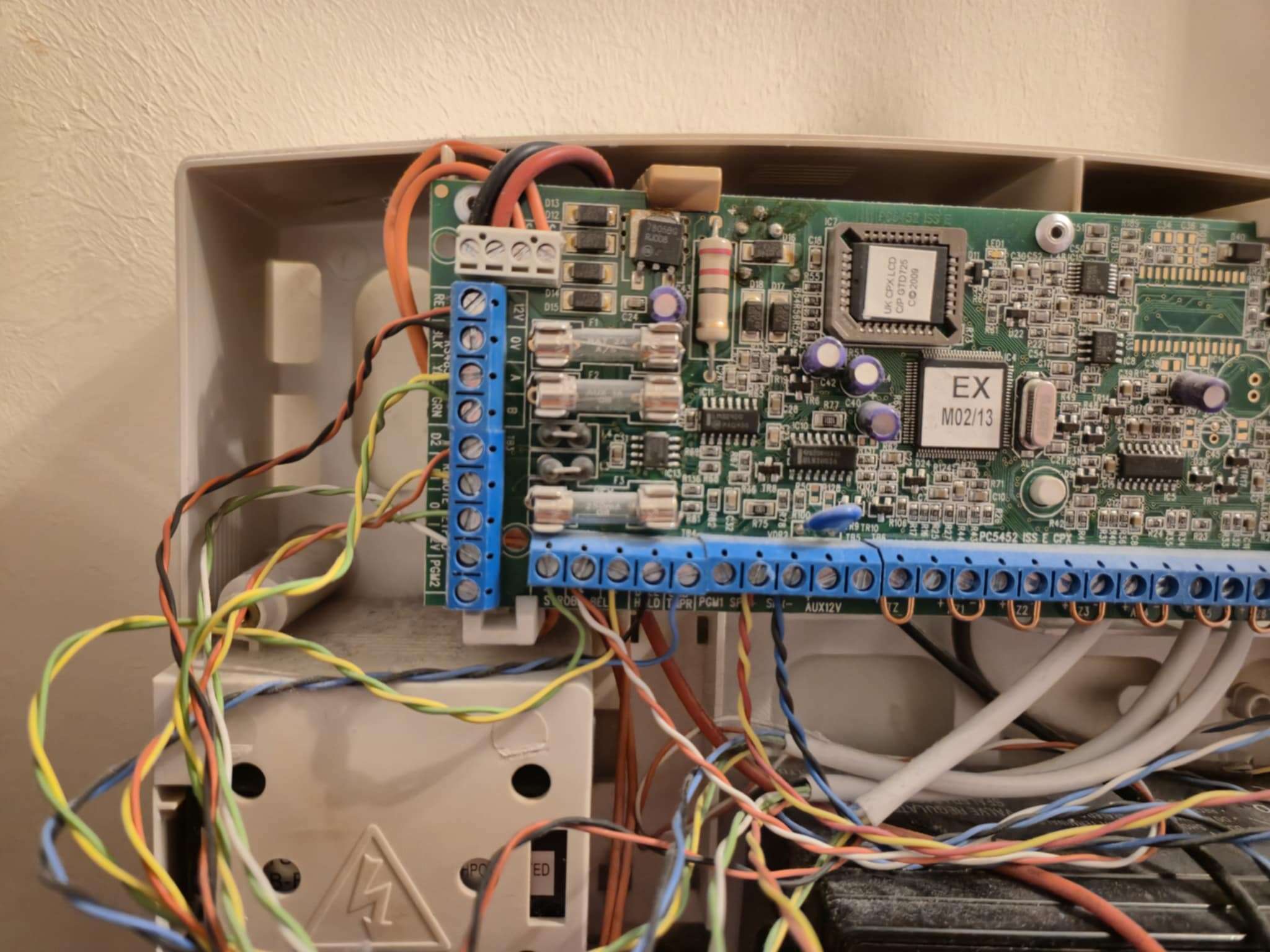

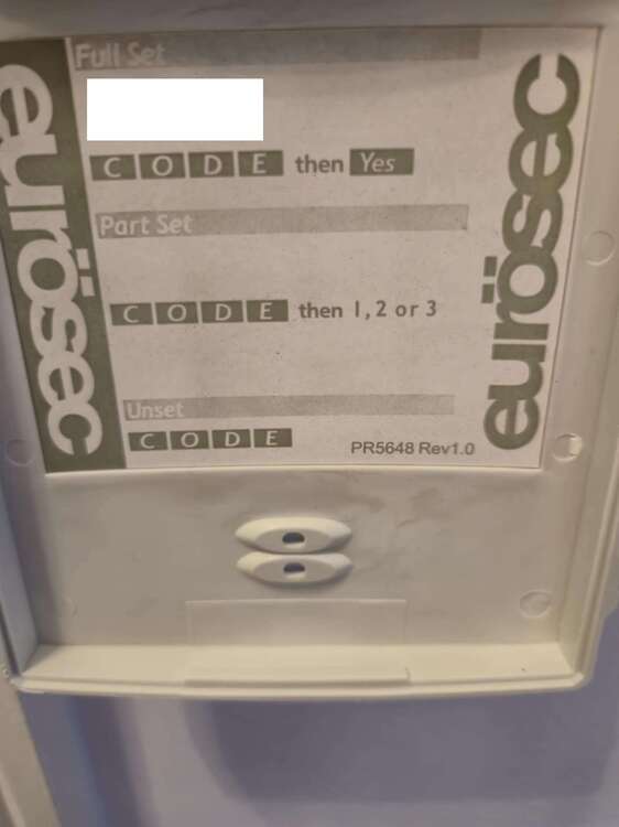

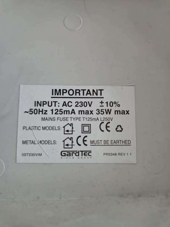

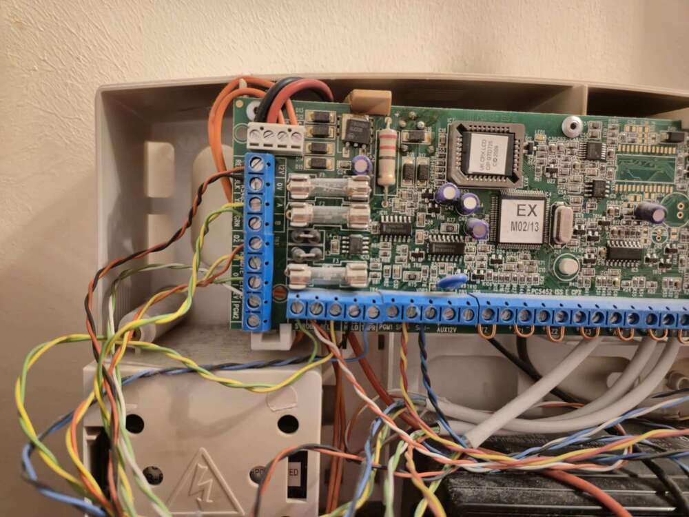

Morganator190 Posted Wednesday at 00:13 Share Posted Wednesday at 00:13 Hi hope you can help, ive worked on alarms previously. I suspect our alarm is engineer code changed and locked. On inspection of the pcb board, the main IC chip looks socketed. Is it possible to dump the chip, change the engineers code and re flash back, retaining user and aux settings? If not, is it possible to keep all PIR, door contacts etc and install a new unit instead? Here are some photos of the current installed alarm. Its suspected to be installed 10 years ago, i believe the company has gone out of business and would prefer to setup and control my alarm system. Its currently got issues where one of the door contacts failed and after replacing the alarm won't accept it. After 2 years of the alarm not been set it randomly goes off, suspecting fuse or battery issues. So ive disconnected all power to the unit until i figure out what to do next. Thanks Link to comment https://www.thesecurityinstaller.co.uk/community/topic/47347-help-with-re-flashing-or-replacing-unit-not-sure-on-exact-model/ Share on other sites More sharing options...
al-yeti Posted Wednesday at 01:05 Share Posted Wednesday at 01:05 51 minutes ago, Morganator190 said: Hi hope you can help, ive worked on alarms previously. I suspect our alarm is engineer code changed and locked. On inspection of the pcb board, the main IC chip looks socketed. Is it possible to dump the chip, change the engineers code and re flash back, retaining user and aux settings? If not, is it possible to keep all PIR, door contacts etc and install a new unit instead? Here are some photos of the current installed alarm. Its suspected to be installed 10 years ago, i believe the company has gone out of business and would prefer to setup and control my alarm system. Its currently got issues where one of the door contacts failed and after replacing the alarm won't accept it. After 2 years of the alarm not been set it randomly goes off, suspecting fuse or battery issues. So ive disconnected all power to the unit until i figure out what to do next. Thanks If wiring is good, just change panel and keypad and probably bell and probably some detectors You will end up eventually changing it all lol Link to comment https://www.thesecurityinstaller.co.uk/community/topic/47347-help-with-re-flashing-or-replacing-unit-not-sure-on-exact-model/#findComment-530465 Share on other sites More sharing options...
MrHappy Posted Wednesday at 09:02 Share Posted Wednesday at 09:02 (edited) Options - CPX from Ebay 595 / 600 + Keypad from ebay or replace everything... Edited Wednesday at 09:15 by MrHappy Mr Veritas God Link to comment https://www.thesecurityinstaller.co.uk/community/topic/47347-help-with-re-flashing-or-replacing-unit-not-sure-on-exact-model/#findComment-530467 Share on other sites More sharing options...
sixwheeledbeast Posted Wednesday at 09:26 Share Posted Wednesday at 09:26 I'd get rid, flaky Risco stuff. But yes it's totally wireless detection so replace devices too. Link to comment https://www.thesecurityinstaller.co.uk/community/topic/47347-help-with-re-flashing-or-replacing-unit-not-sure-on-exact-model/#findComment-530469 Share on other sites More sharing options...
