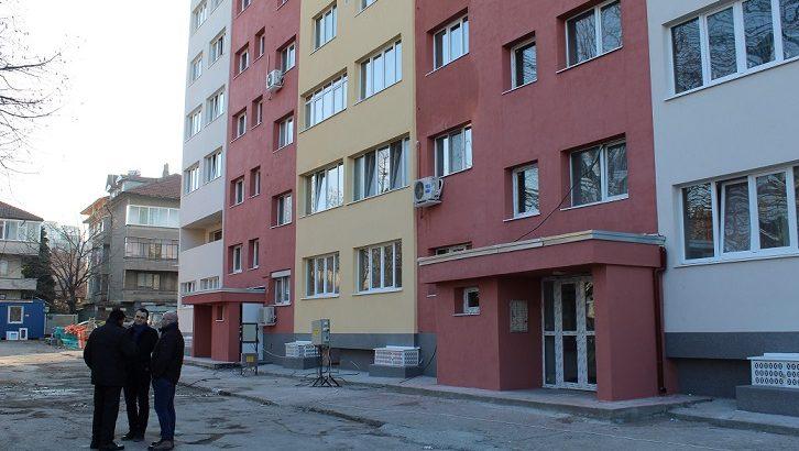

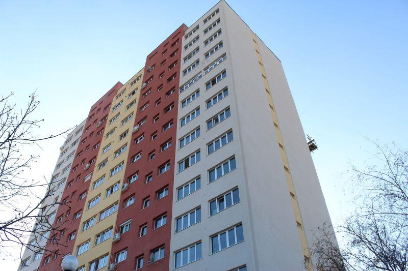

CYPER Posted June 30, 2019 Author Share Posted June 30, 2019 (edited) 1 hour ago, Specialist said: It would be a lot better to install the equipment on the outer wall of the stairwell at 2 - 3m height, PIR should then have no problems working and your 200watt flood will actually be able to give a reasonable amount of illumination. Personally, as others have said. I don't think a PIR at 10m vertical height is going to work. And your flood is more than likely going to look like a Glow worm. Who does the existing carpark lighting belong to ?. Google Street view images are from 2012, so quite old. Recently the exterior of the building has been renovated and thermal insulation installed, so it looks like this now: The issue is that most residents don't mind the installation as long as they don't have to pay for it, thus I am footing the bill for the equipment and the electricity will be shared between the car owners. I might be able to install the RIP at the entrance, but that means 2x 10m cables running down to the sensor and then up again to the floodlight, which is doable I guess. Existing car park lights belong to the city and they certainly don't work if they are even there. 42 minutes ago, sixwheeledbeast said: You would need multiple PIR's to cover that area. I imagine that cheap light will die quickly. Do the street lights in the centre of the car park not work? I would say bulkhead type fittings with motion on each side of the porches would be suited better. I don't need to cover the entire area, just around the right block entrance, so half side of the block. So like 10x10m area max. 18 minutes ago, Specialist said: If the landlord has control of the existing lighting and it works, the simplest upgrade would be to remove the existing lights and fit a Unistrut arm to each pole. 2 decent LED floods on each arm & angled accordingly should give plenty of lighting. Each apartment has its own owner/landlord. There is no central authority here. People are poor, nobody wants to spend any money. I have already purchased the flood light and will be doing this myself with the help of a few other owners. There are 3 apartments per floor, so 45 in total for the right entrance. Edited June 30, 2019 by CYPER 1 1 Link to comment https://www.thesecurityinstaller.co.uk/community/topic/42900-what-movement-sensor-and-led-floodlight-wattage-for-10m-height/page/2/#findComment-485620 Share on other sites More sharing options...
