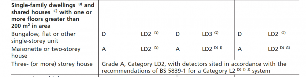

Thanks, I was initially advised it needs Grade B, LD2 .. are you sure it's Grade A , The architect and BC both initially specc'd it at design stage as Grade B, and then...still at design stage they approved it to not require grade B such to allow it to be interlinked.
However A and B has a single point of failure in the central system (worse - if it set on fire itself, as rare as that may be) unlike battery backed up interlinked which has no single point of failure - so where I'm protecting my family I want the best solution and that's where BC have agreed interlinked is better for my situation.
Think of it like this...what is better, 10 security guards each with a megaphone and a walkie talkie (equivalent of interlinked) or 1 security guard with 9 CCTV screens and a megaphone (centralised system)?
It's somewhat a grey area for the electricians ... I agree, I just want a solution that is safe and best for my family and I simply have no good defense as to why for a one family dewlling that centralised is better than interlinked....I would welcome any defense here as I really would like someone to give a good reason why a robust interlinked is a worse solution to a cheaper centralised system?
Thanks for that Simlec ! How bizarre that both specced/requested Grade B - i don't think there's much difference with Grade A (but will check exactly what). whilst reluctant for the reasons above, I'm likely going to centralised now anyway and will probably add in some standalone detectors for peace of mind, so hopefully grade A won't make too much difference..will find out.
As you can see Part B of building regs asks for grade B but from an out dated document. It should be BS 5839-6:2013
BS 5839-6:2013 supersedes BS 5839-6:2004, which is withdrawn.
