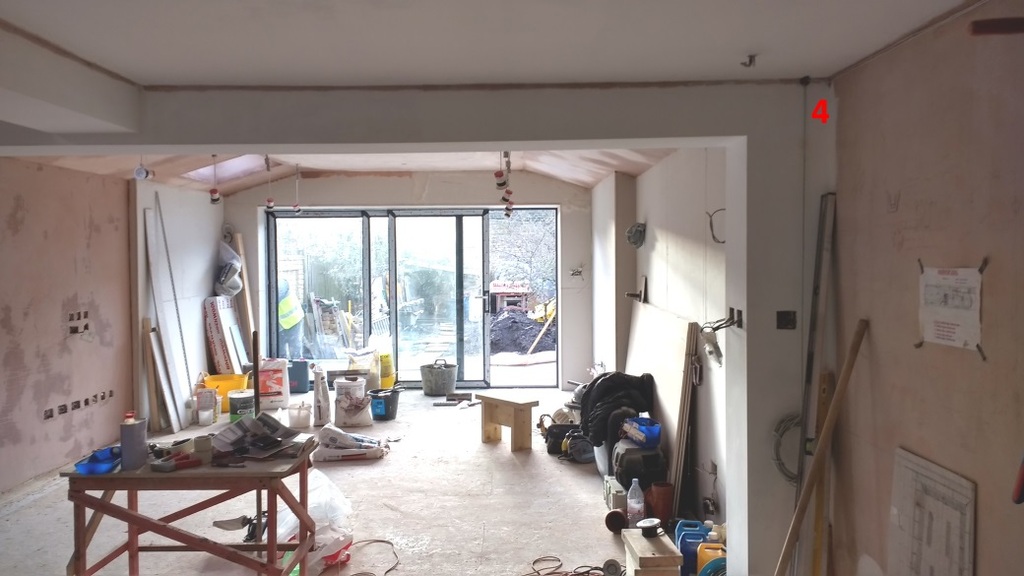

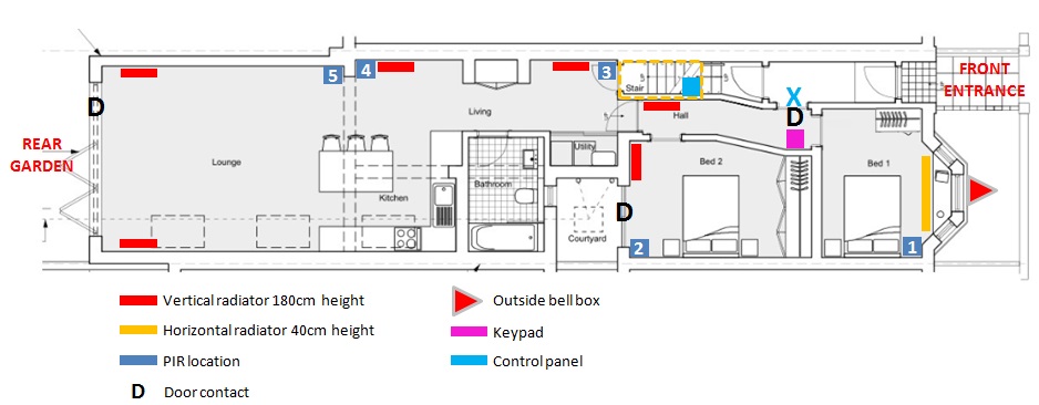

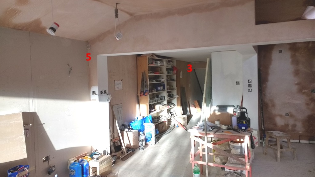

Morning folks, sorry for the delay, but a small update for you all, with the added Brucey Bonus of a couple questions! :o:D
In terms of cabling, I've run 6 core to most locations and ordered some Elmdene door contacts (flush mount for wooden doors, surface mount for aluminium sliding patio doors in living room / master bedroom, EOL resistors as recommended, so thanks for that! :D
In terms of PIR sensors, I've gone for Texecom's Premier Elite DT sensor, as recommended (thank you Mr DataDiffusion) so I get both volumetric and microwave coverage. So far, so good.
However, I still have some sensor positioning questions...pics to illustrate.
Locations #1 + #2 are fine, I think we agree on that. Main issue is what to do about the big open space that is the kitchen / living room?
(1) Location #5 is about 5.5 metres away from the large patio doors but still faces / look at them. This would cover the living room area. Is this an ok location for the DT sensor or should it be elsewhere in the room?
(2) I'd like a DT sensor in location #3 if possible, as that will cover anybody trying to sneak in via the bathroom...would location #3 be ok? I would like to avoid location #4 as it is directly above a vertical radiator, whereas with #3 it is further away from the rad.
(3) If I go with #5 and #3, because of the beam that is boxed in by the plasterboard, they wouldn't see each other hence won't false alarm? Or would they?!
5 is as good as it gets whilst still avoiding the rads...
3 and 4 for me much of a muchness, if 3 is a little bit further from the rad, that's possibly better.
The microwave beam can go through walls - but that's why it's adjustable to prevent that when it's installed.
