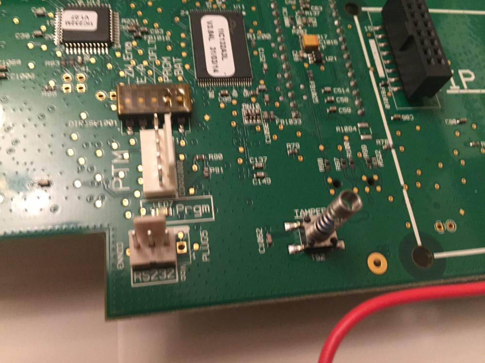

james.wilson Posted April 9, 2016 Share Posted April 9, 2016 2 hours ago, thereishope said: Thanks James, yep it has a plastic tube on a spring soldered onto the PCB. ie. No wires to hook up like on the older models. I was hoping that I was just missing a menu option to restore the alarm but sounds like it may need to be returned to Risco for replacement/repair can you take a pic of the main board and upload it? securitywarehouse Security Supplies from Security Warehouse Trade Members please contact us for your TSI vetted trade discount. Link to comment https://www.thesecurityinstaller.co.uk/community/topic/39975-risco-agility-3-tamper-alarm-error-reset/#findComment-444342 Share on other sites More sharing options...
thereishope Posted April 9, 2016 Author Share Posted April 9, 2016 Hi Peter & James, I'm on Australian time so just got up before my wife tells me off again for playing too much trying to get it working! I have tested putting the tamper switch in the 2 different settings (box only, wall & box). I've shut the lid with the 2 screws and it all seems flush and spring fitted/functioning correctly with the clear push button (trigger, clear PC molded tube). I gave the spring a gentle tug but couldn't quite tell if the pressure plate making contact is at fault. I've contacted the Australia Risco support but the don't work weekends like you guys! I sort of thought initially it was an error on my side with the clearing the alarm. James please find the images attached. Link to comment https://www.thesecurityinstaller.co.uk/community/topic/39975-risco-agility-3-tamper-alarm-error-reset/#findComment-444391 Share on other sites More sharing options...
