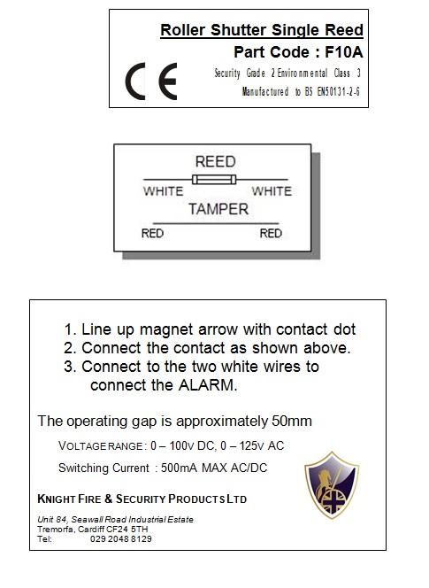

Below is a screenshot of our non-resistored RSC install sheet for your reference:
hyK1r4a.jpg?1

Might as well leave it here Spike, nothing wrong with a double input of this sort. Fair 50mm gap..a good suitable all-rounder.
