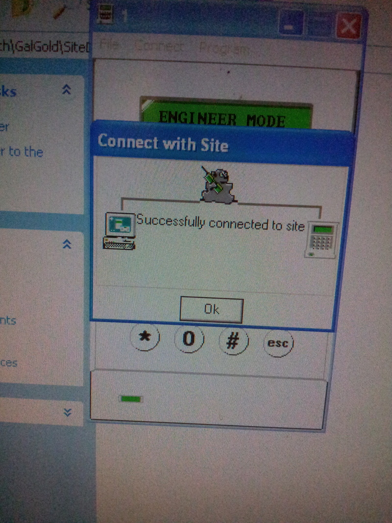

dwdave Posted July 25, 2015 Author Share Posted July 25, 2015 guys. im suspecting that my rs232 panel might have had it. no way to test it and no way to replace it. my version of rss is old so id need to replace that and the panel for an integrated rs232 one. Not really viable. I've put a blank password when connecting to a new site and it just hangs on the checking password. The led to show pc connection doesnt light up. It worked fine last week. 'till the next question ... Link to comment https://www.thesecurityinstaller.co.uk/community/topic/38707-galaxy-gold-to-galaxy-rs232-module-not-connecting/page/3/#findComment-425254 Share on other sites More sharing options...
dwdave Posted July 25, 2015 Author Share Posted July 25, 2015 not sure how, but another disconnect, reconnect, cleared the tamper, turned around three times and touched my nose .... et voila. 'till the next question ... Link to comment https://www.thesecurityinstaller.co.uk/community/topic/38707-galaxy-gold-to-galaxy-rs232-module-not-connecting/page/3/#findComment-425303 Share on other sites More sharing options...
dwdave Posted July 25, 2015 Author Share Posted July 25, 2015 ...and then it dropped. 'till the next question ... Link to comment https://www.thesecurityinstaller.co.uk/community/topic/38707-galaxy-gold-to-galaxy-rs232-module-not-connecting/page/3/#findComment-425320 Share on other sites More sharing options...
