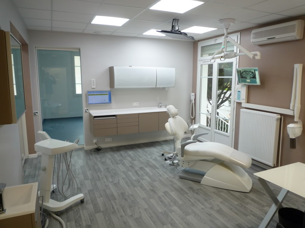

If you're interested though (!) one is an air turbine, then there are two electric/electronic micromotors and an ultrasonic scaler.
It's all controlled electronically from a touchscreen on the unit and although I can (and often do) have instruments connected to all of them at once, the control unit only allows one to be used at a time.
It's the cart on the left (again, if you're interested! :P)

Oxo, well it's the dentist that counts I guess but it's nice to give a good impression.  Implant surgery room through the sliding door at the back.

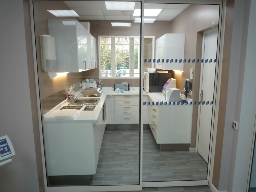

Sterilisation room (instrument cart touch screen can be seen on the left):
The flatscreen above the chair will be great for catching Rugby/football world cups but it's normally showing Bluerays of tropical fish etc with relaxing music.
