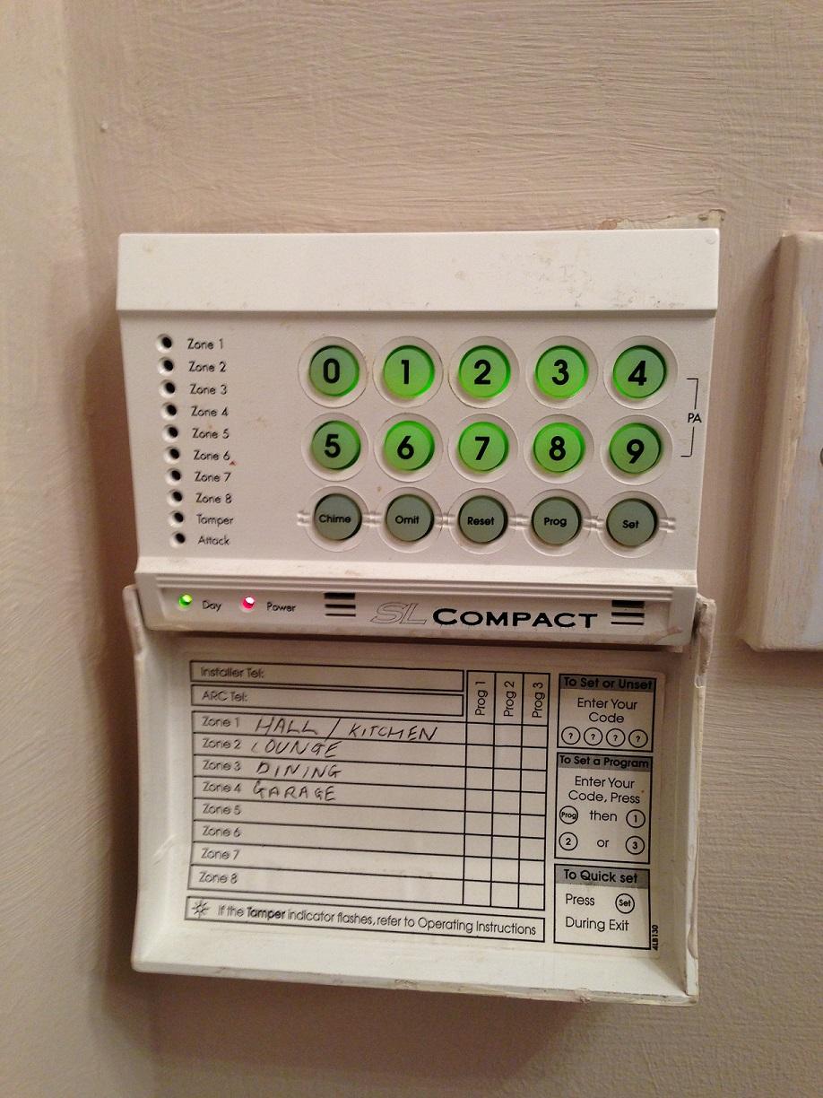

Abaid Sajjad Posted January 9, 2013 Share Posted January 9, 2013 hi i need a manuel possibly engineering manuel to get to know this alarm i have fitted in my new house save me changing cuz its well fitted and looks nice any information regarding model no etc thanks other day it was keep chiming wen you move i read in one forum press chime - 0 -then reset and it worked but i stil need bit more information about it Link to comment https://www.thesecurityinstaller.co.uk/community/topic/33866-manuel-for-sl-compact-see-pictures/ Share on other sites More sharing options...

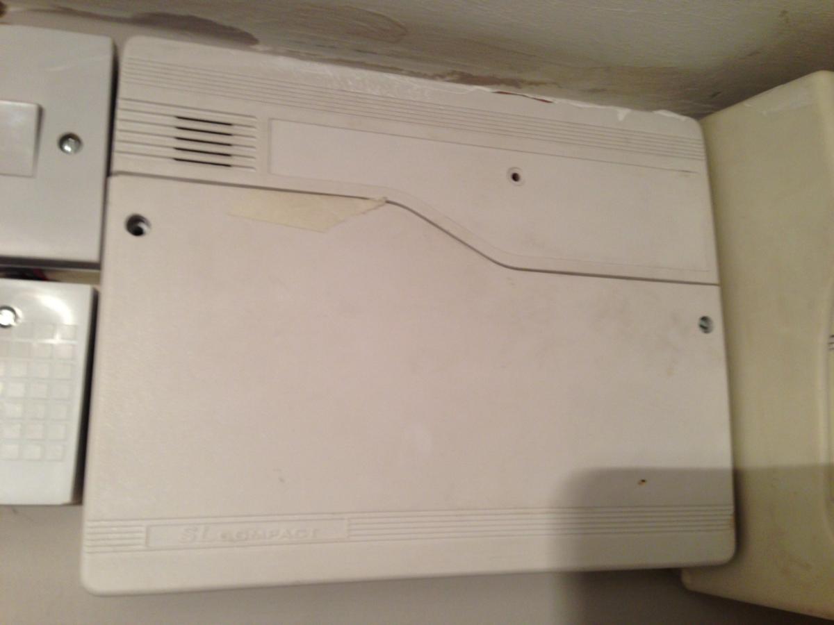

Oxo Posted January 9, 2013 Share Posted January 9, 2013 Please read the forum rules. WE DO NOT GIVE OUT ENGINEERING MANUALS Oh and that switched spur is incorrect. So is having the internal sounder mounted by the panel. Link to comment https://www.thesecurityinstaller.co.uk/community/topic/33866-manuel-for-sl-compact-see-pictures/#findComment-299182 Share on other sites More sharing options...
Amps Posted January 9, 2013 Share Posted January 9, 2013 So is having the internal sounder mounted by the panel. Whys that mate? Link to comment https://www.thesecurityinstaller.co.uk/community/topic/33866-manuel-for-sl-compact-see-pictures/#findComment-299188 Share on other sites More sharing options...
Oxo Posted January 9, 2013 Share Posted January 9, 2013 Errrr, atracts the burglar to the panel and they wreck it. Always been taught to keep any sounders well away from the panel. Link to comment https://www.thesecurityinstaller.co.uk/community/topic/33866-manuel-for-sl-compact-see-pictures/#findComment-299191 Share on other sites More sharing options...

Lwillis Posted January 9, 2013 Share Posted January 9, 2013 Wouldn't agree that it " its well fitted and looks nice" And by the looks of the zone list it's pirs for entry exit - which I've normally tried to avoid as the front door can be left wide open an the system would still set Link to comment https://www.thesecurityinstaller.co.uk/community/topic/33866-manuel-for-sl-compact-see-pictures/#findComment-299223 Share on other sites More sharing options...
