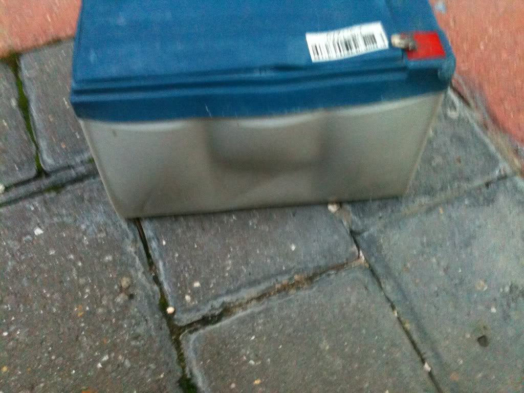

Lwillis Posted July 12, 2012 Share Posted July 12, 2012 hopefully it doesn't looks like this . Link to comment https://www.thesecurityinstaller.co.uk/community/topic/33162-veritas-panel-very-warm/#findComment-285999 Share on other sites More sharing options...

Rulland Posted July 13, 2012 Share Posted July 13, 2012 Replaced a few access systems recently-and batteries in them were all bulging and flucked (bats 10 yrs plus-one 1993),not defending any manufacturer in particular-but if they're not serviced regularly, by whoever, then it's going to have an adverse affect on the trannies etc and cause other probs. Waits with baited breath for 'Le Happy' to comment on 'trannies', lol Link to comment https://www.thesecurityinstaller.co.uk/community/topic/33162-veritas-panel-very-warm/#findComment-286017 Share on other sites More sharing options...
