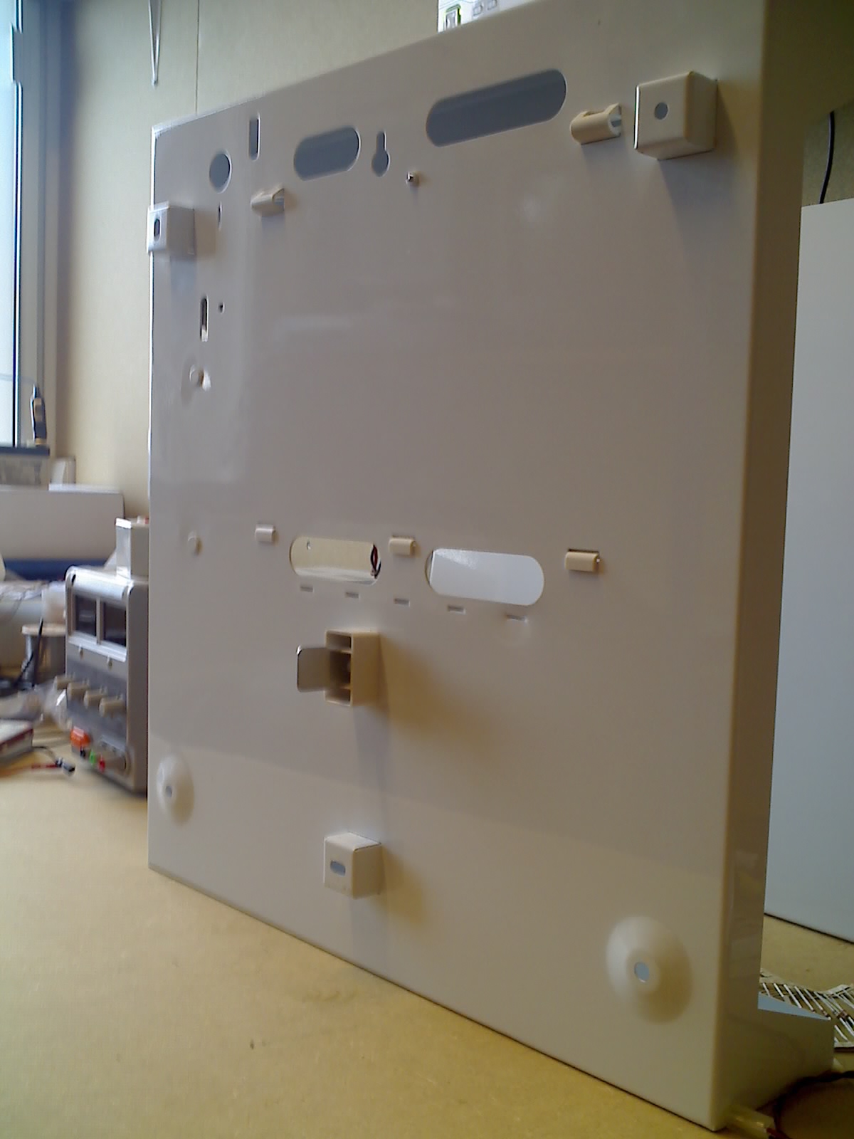

alterEGO Posted January 8, 2011 Share Posted January 8, 2011 Lazy fooker, drill what you need. Use penny washers to make up the stand off. Quiclk tip: Drill as needed offer panel up as template. Drill plug ect. Use super glue to hold washers in palce on back of panel when mounting. I normally use small off cut of alli tube or conduit if i need extra fixings. The holes look to be in place on this one, just not the stand off. Thats one issue i have with premiers, cable entry is a pain as they are all in the centre under PCB, so on takeovers you often have a problem. Also the knock outs are sh!te, you need a lump hammer to get them out. Link to comment https://www.thesecurityinstaller.co.uk/community/topic/30539-i-on-160/page/3/#findComment-265061 Share on other sites More sharing options...
hpotter Posted January 8, 2011 Author Share Posted January 8, 2011 one good thing abt the I-on, no need to worry abt hiding decor on t/o. ali tube have used, esp when fixing to uneven brickwork eg. Link to comment https://www.thesecurityinstaller.co.uk/community/topic/30539-i-on-160/page/3/#findComment-265067 Share on other sites More sharing options...

Guest Oxo Posted January 8, 2011 Share Posted January 8, 2011 Have to agree with stubborn knockouts. Always have a 20mm holesaw and open grommets. Absoloutely needed on t/o`s. Link to comment https://www.thesecurityinstaller.co.uk/community/topic/30539-i-on-160/page/3/#findComment-265071 Share on other sites More sharing options...
alterEGO Posted January 8, 2011 Share Posted January 8, 2011 Have to agree with stubborn knockouts. Always have a 20mm holesaw and open grommets. Absoloutely needed on t/o`s. Try it on a prem, almost no where to drill. We have one site with the panel on its side and bat zipped in place. Link to comment https://www.thesecurityinstaller.co.uk/community/topic/30539-i-on-160/page/3/#findComment-265072 Share on other sites More sharing options...

alterEGO Posted January 8, 2011 Share Posted January 8, 2011 At the least they could weld a bit of steel in place to hold bats if installed on side, however i would rather a row of side cable entry points. Link to comment https://www.thesecurityinstaller.co.uk/community/topic/30539-i-on-160/page/3/#findComment-265079 Share on other sites More sharing options...
AdrianMealing Posted January 8, 2011 Share Posted January 8, 2011 Problem with knockouts in the side of a premier case is, the side of the case is part of the lid, if you put cables through it how would you get the lid off, without the risk of damaging cables? Take your point an batteries and zip tie points, and i agree the knockouts are a cow to get out amealing@texe.com Head of Industry Affairs Visit Our Website Texecom Link to comment https://www.thesecurityinstaller.co.uk/community/topic/30539-i-on-160/page/3/#findComment-265124 Share on other sites More sharing options...
