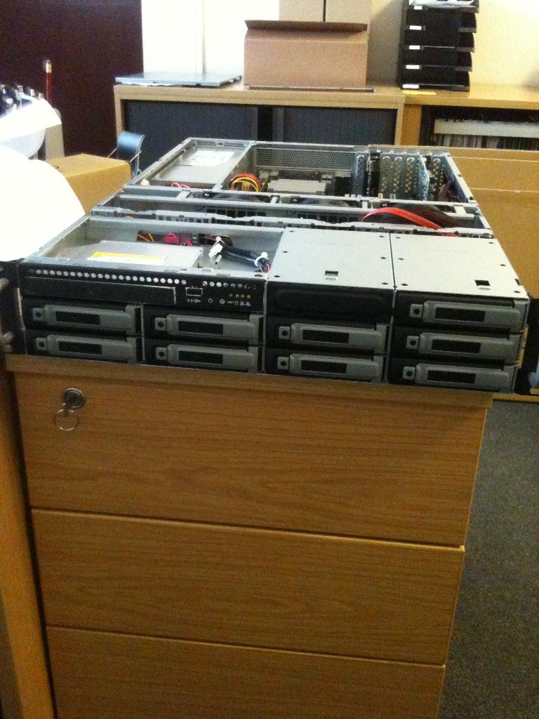

whistle Posted September 17, 2010 Share Posted September 17, 2010 I have 2 of these to fit on Monday.. 32 TB of harddisk.. Link to comment https://www.thesecurityinstaller.co.uk/community/topic/29776-propper-dvr/ Share on other sites More sharing options...

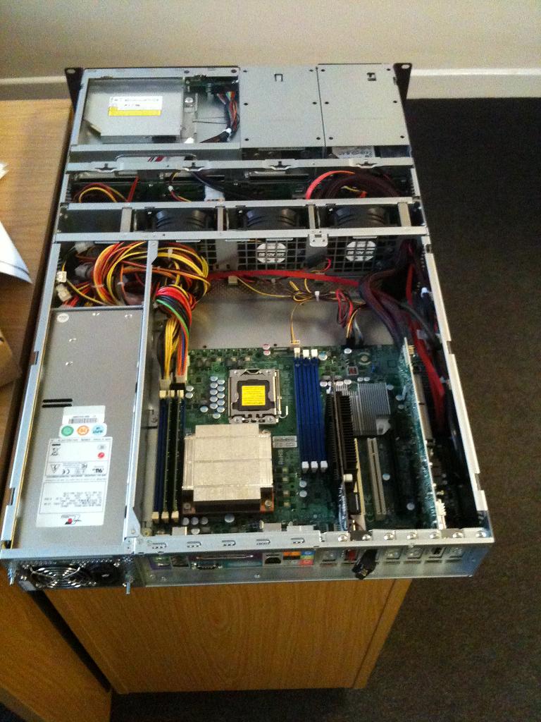

MrHappy Posted September 17, 2010 Share Posted September 17, 2010 well its looks like an average 2u server with a capture card ? impress me with what it is & what its does.... PS desk cabinet w/o handles ? Mr Veritas God Link to comment https://www.thesecurityinstaller.co.uk/community/topic/29776-propper-dvr/#findComment-252097 Share on other sites More sharing options...

Guest Oxo Posted September 17, 2010 Share Posted September 17, 2010 PS desk cabinet w/o handles ? Under slots probs, looks like council offices Link to comment https://www.thesecurityinstaller.co.uk/community/topic/29776-propper-dvr/#findComment-252104 Share on other sites More sharing options...

MrHappy Posted September 17, 2010 Share Posted September 17, 2010 LOL @ capture card.. ? since I'm feeling bitching lol at the lack of redundant psu's Mr Veritas God Link to comment https://www.thesecurityinstaller.co.uk/community/topic/29776-propper-dvr/#findComment-252130 Share on other sites More sharing options...
hpotter Posted September 18, 2010 Share Posted September 18, 2010 I have 2 of these to fit on Monday.. 32 TB of harddisk.. corner shop in toxteth? Link to comment https://www.thesecurityinstaller.co.uk/community/topic/29776-propper-dvr/#findComment-252198 Share on other sites More sharing options...
james.wilson Posted September 19, 2010 Share Posted September 19, 2010 what board you used whistle (ie mb) also i assume win 2k3/8 server and milestone? id also be interested in your choice of raid card? also sas or sata? id assume sata? also what drives, and raid if sata raid6 or 5? securitywarehouse Security Supplies from Security Warehouse Trade Members please contact us for your TSI vetted trade discount. Link to comment https://www.thesecurityinstaller.co.uk/community/topic/29776-propper-dvr/#findComment-252350 Share on other sites More sharing options...
whistle Posted September 19, 2010 Author Share Posted September 19, 2010 Not sure what MB Yes 2K3 - Milestone Not sure on what raid card but i know its using raid 5 16 x 2tb sata Hitachi drives Link to comment https://www.thesecurityinstaller.co.uk/community/topic/29776-propper-dvr/#findComment-252353 Share on other sites More sharing options...
james.wilson Posted September 19, 2010 Share Posted September 19, 2010 word from the wise mate raid 5 can only handle 1 drive failure. 32 tb will take a while to rebuild and will stress the drives. 2 drives fail and the array dies. your talking hours and hours of rebuild time. Also which hitachi drives, they make some craking drives.... wouldnt say the 2tb sata was one of em? i suppose if 2k3 you could be using soft raid but i doubt it on an array that size. probably an adaptec. id suggest hardware raid for this, and id seriously advise raid 6. But you will lose a bit of capacity. looking at the case it has a hotswap backplane? if so there isnt 16 drives in it, you mounting some internally, if so be cautios with the cooling. redundant psu is desirable but not essential imo, but you are likly to expereiance drive failures using comsumer drives at that duty and raid level. but dont take that away from the fact that few will see that sort of kit let alone install it. But if its a new one for you...... good luck securitywarehouse Security Supplies from Security Warehouse Trade Members please contact us for your TSI vetted trade discount. Link to comment https://www.thesecurityinstaller.co.uk/community/topic/29776-propper-dvr/#findComment-252355 Share on other sites More sharing options...
