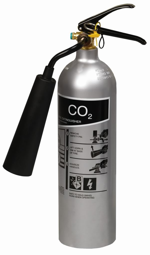

galaxyclass Posted September 26, 2008 Share Posted September 26, 2008 I personally prefer fire detectors connected to the intruder system, (if you have a decent panel that is). i have a keypad next to my bed so that when a detector operates i know where the fire is (each fire detector on seperate zone) i use a seperate fire output to trigger GSM communicator and another plus point is i have never had a false activation ( i use hochiki conventional on conversion base plus a co2 in living room. Link to comment https://www.thesecurityinstaller.co.uk/community/topic/23611-mains-powered-smokes-or-on-intruder-alarm/page/3/#findComment-211717 Share on other sites More sharing options...
Chorlton Posted September 26, 2008 Share Posted September 26, 2008 I personally prefer fire detectors connected to the intruder system, (if you have a decent panel that is).i have a keypad next to my bed so that when a detector operates i know where the fire is (each fire detector on seperate zone) i use a seperate fire output to trigger GSM communicator and another plus point is i have never had a false activation ( i use hochiki conventional on conversion base plus a co2 in living room. now thats home safety Available by PM for Link to comment https://www.thesecurityinstaller.co.uk/community/topic/23611-mains-powered-smokes-or-on-intruder-alarm/page/3/#findComment-211721 Share on other sites More sharing options...
galaxyclass Posted September 26, 2008 Share Posted September 26, 2008 LOL, whoops ok CO detector. Link to comment https://www.thesecurityinstaller.co.uk/community/topic/23611-mains-powered-smokes-or-on-intruder-alarm/page/3/#findComment-211769 Share on other sites More sharing options...
