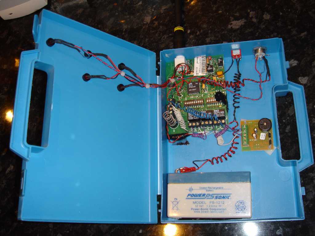

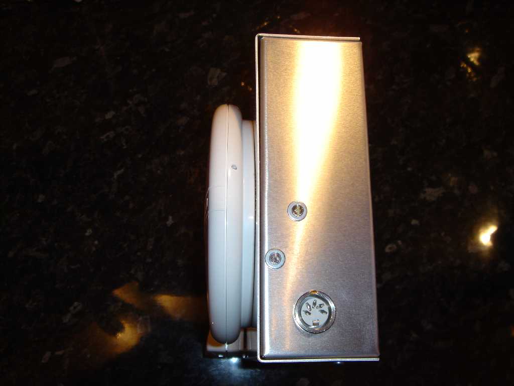

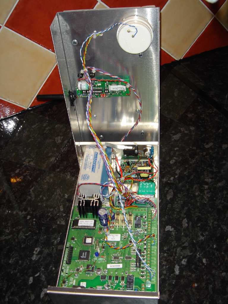

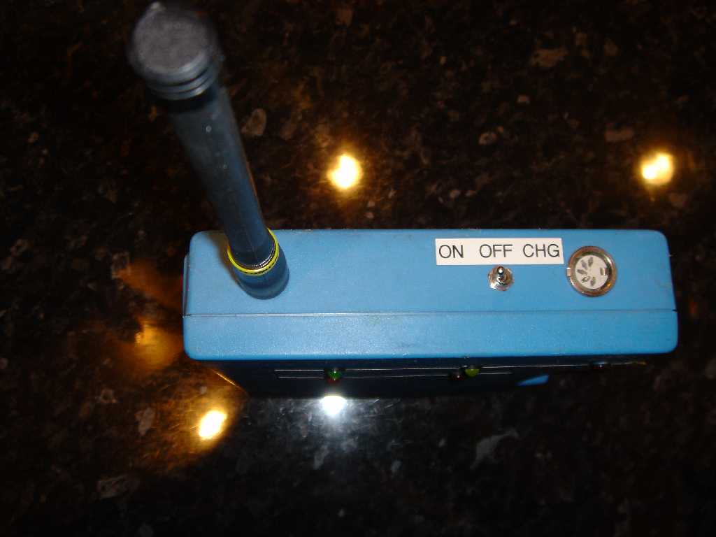

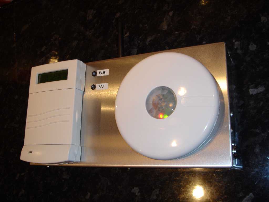

norman Posted April 2, 2006 Share Posted April 2, 2006 Bit sad but, here's one I made earlier. Cost would be prohibitive but it was a one off for myself, fully portable and a radio link to the main system for texting purposes. Nothing is foolproof to a sufficiently talented fool. Link to comment https://www.thesecurityinstaller.co.uk/community/topic/10058-caravan-alarm/#findComment-93863 Share on other sites More sharing options...
Guest RICHL Posted April 2, 2006 Share Posted April 2, 2006 No Norm, thats not sad at all. Link to comment https://www.thesecurityinstaller.co.uk/community/topic/10058-caravan-alarm/#findComment-93865 Share on other sites More sharing options...
Barsnake Posted April 2, 2006 Share Posted April 2, 2006 thats one modified scanny radio panic button looks good tho Link to comment https://www.thesecurityinstaller.co.uk/community/topic/10058-caravan-alarm/#findComment-93890 Share on other sites More sharing options...
