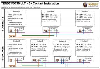

  12. You don't state which contacts you used on that installation but for future reference, our G3+G2 YEND74 and G2 D75MULTI are specifically designed for multi contact configurations, as detailed in the diagram below:
