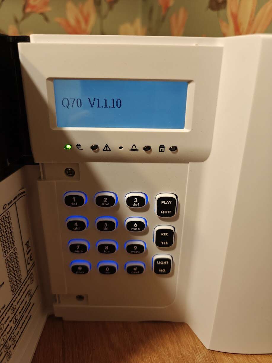

The software version is : 1.1.10

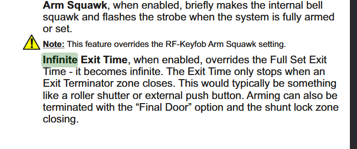

On there it showed a setting called Infinite Exit - ON
This peaked my curiosity even more and I went and looked in the engineers manual.
I turned it OFF and now the alarm countdown works and it arms succesfully.
Such a stupid thing to have turned on by default, wasted about 5 hours of my time, oh well.
