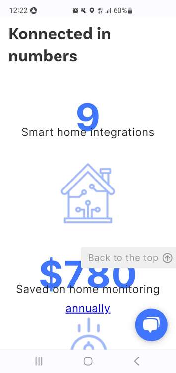

norman Posted October 7, 2023 Share Posted October 7, 2023 Didn't PJ connect his Alexa to his alarm or did I dream that? The numbers are impressive.. Nothing is foolproof to a sufficiently talented fool. Link to comment https://www.thesecurityinstaller.co.uk/community/topic/46144-what-does-a-speaker-output-do/page/2/#findComment-520366 Share on other sites More sharing options...
james.wilson Posted October 7, 2023 Share Posted October 7, 2023 The ha thing is impressive we all want that it's the only thing that knows when we are out I bed or in securitywarehouse Security Supplies from Security Warehouse Trade Members please contact us for your TSI vetted trade discount. Link to comment https://www.thesecurityinstaller.co.uk/community/topic/46144-what-does-a-speaker-output-do/page/2/#findComment-520374 Share on other sites More sharing options...
