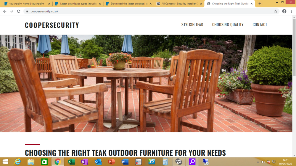

    it appears "cooper security" have a new product range ?

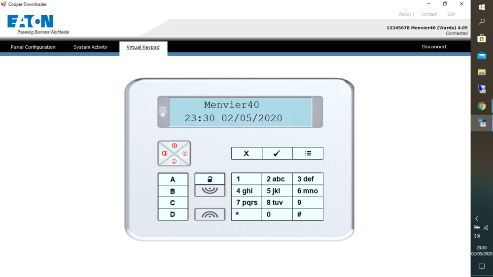

**** me it finally works,
next partof the puzzle is get it work over a nano

So what was stopping it from working ?
the software is bit a flakey,
default port no. for downloader is 55132
I changed it to 85 & it worked
I changed it to 6969 no worky
88 no worky,
back to 85 & it works
I know the board is from a skip, by I think the software may belong in one too
should you change the banner text-
download it into the controls, the old banner is displayed until the user code is entered,
odd...
88 no worky,
What made you pick 85?
I had hiwatch camera on port 85 on the bench the other week & knew my work router to house router was working on port 85 in the past
it appears the controls do not take up the software changes until power cycled or a code in entered on the psychical keypad
however the downloading software still won't load on the intended win8 machine, the same file loads on my lenovo & acer laptops
there all 64 bit machines....
