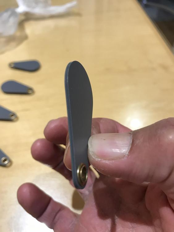

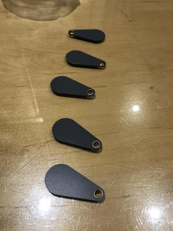

grantc Posted October 1, 2018 Share Posted October 1, 2018 Post a pic of the actual tag your using Link to comment https://www.thesecurityinstaller.co.uk/community/topic/42422-pyronix-proximity-tags/#findComment-479627 Share on other sites More sharing options...
jonnas Posted October 1, 2018 Author Share Posted October 1, 2018 Link to comment https://www.thesecurityinstaller.co.uk/community/topic/42422-pyronix-proximity-tags/#findComment-479628 Share on other sites More sharing options...
