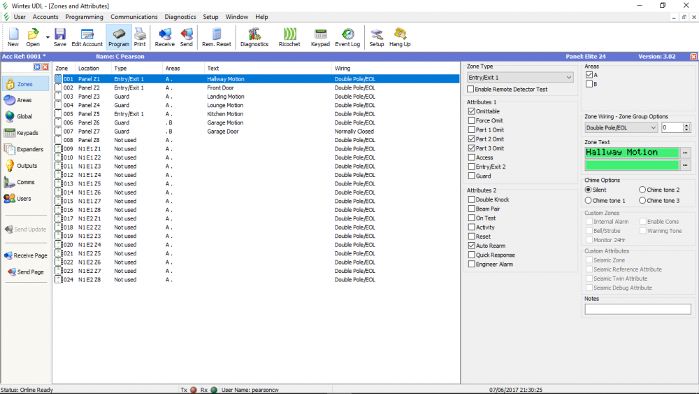

The system is set into 2 areas;
Area A = Ground Floor and Garage
Area B = First Floor

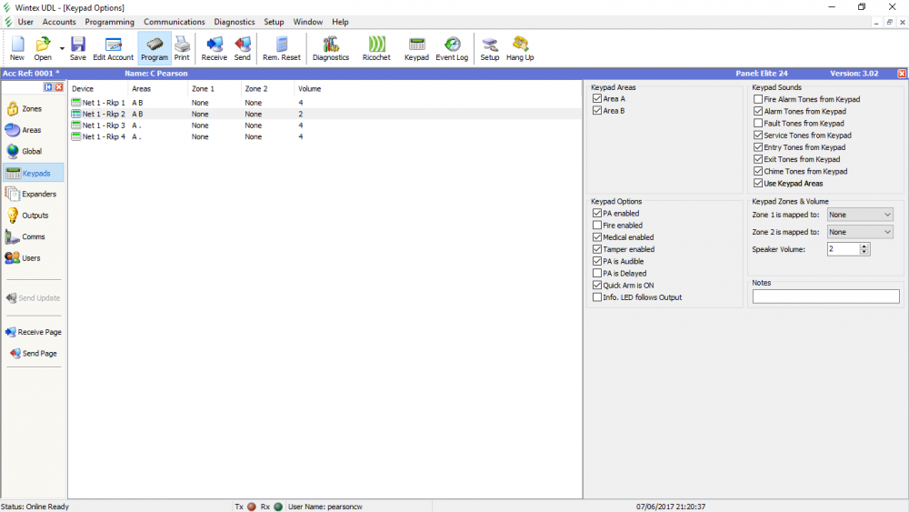

The control pad in the hall is set to Area A&B but I havent got the "use keypad areas" box checked in wintex, I tried it and it made no difference.
The second control pad is in the second floor landing, This is set to area a only, the idea being that I set the alarm from the second floor pad at bed time and we can roam the first and second floors (no sensors on second floor) and then either dis arm from second floor in the morning or go down stairs and the hallway sensor will start the entry timer.

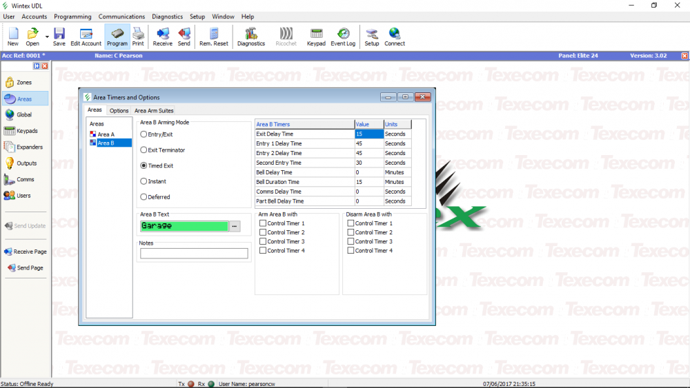

Sounds like you need may need to use Areas and Part Arms in a different way.
I don't know the layout of the house and keypads or what you need to arm.
I would have House and Garage Areas, with a Part Set for Bedtime.
When only arming some of the areas it shows the part arm text as only part of the entire system is armed. A feature that annoys me.
However as said you really should have the house as area a and the garage as area b. Then use part arms within area a.  Also means you can then have the garage armed throughout the day and auto arm it etc
