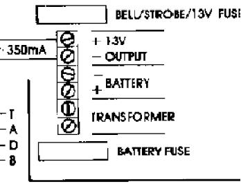

Guest derrick Posted October 12, 2004 Share Posted October 12, 2004 If you get no voltage between batt ov terminal and either end of the fuse holder that would be indicitave of the charging cct being fried, Regards Bellman 26950[/snapback] Thanks for info just so i'm clear on this,.... the fuse @ the bottom of the pcb (labelled batt) has NO +12v across it ....if i test continuity it goes to the 0 volts connector with the black wiring to it ???? any more thoughts ? Link to comment https://www.thesecurityinstaller.co.uk/community/topic/3873-optima-plus-ii/page/2/#findComment-27002 Share on other sites More sharing options...
bellman Posted October 12, 2004 Share Posted October 12, 2004 Hi Derrick, Right, attached is a section of the manual that shows the fuse and connections in question. firstly, disconnect the battery if you have already attached it to the panel battery leads. set your multimeter to dc volts range. put your multimeter black lead onto the terminal labeled battery - and the red multimeter lead onto the batt + you should get 13-14 volts dc accross it. if not put the red lead from your multimeter on the left hand side terminal of the fuse holder whilst keeping the black lead on the batt - connection. you should see voltage there, if not put the red lead onto the right hand side terminal of the fuse holder and see if you get voltage there. if you get no voltage at either of the fuse holder terminals the charging cct is cooked/ if you just get voltage at one of the fuse holder terminals then the fuse has blown. Hope this helps Regards Bellman Service Engineer and all round nice bloke ) The views above are mine and NOT those of my employer. Link to comment https://www.thesecurityinstaller.co.uk/community/topic/3873-optima-plus-ii/page/2/#findComment-27024 Share on other sites More sharing options...

Guest RICHL Posted October 12, 2004 Share Posted October 12, 2004 Also measure the voltage of the dc output, shown Bellmans nifty little diagram - the output should be within 1 volt of the battery voltage with leads connected. Your meter may be wrong thats all, and this will test the meter. Link to comment https://www.thesecurityinstaller.co.uk/community/topic/3873-optima-plus-ii/page/2/#findComment-27046 Share on other sites More sharing options...
