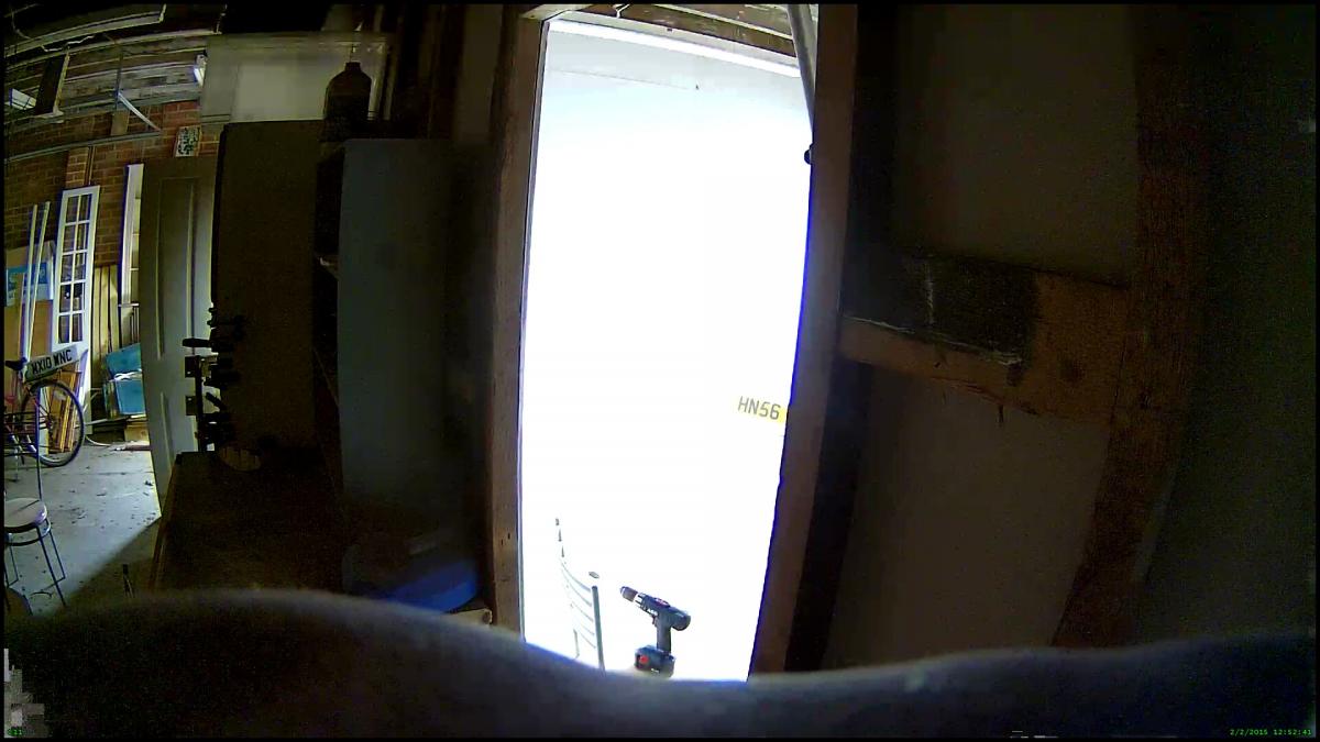

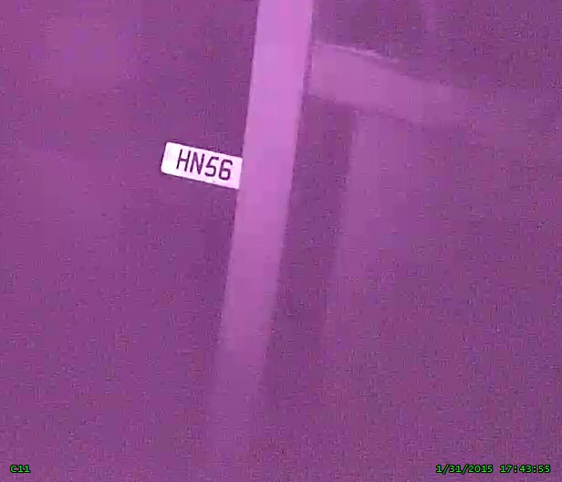

PeterJames Posted February 4, 2015 Share Posted February 4, 2015 But I don't see how any of this will be good for anpr? Or was it just for visiually trying to read it? Mega pixel set up correctly with HLC ect will do it second picture is at night Link to comment https://www.thesecurityinstaller.co.uk/community/topic/38055-new-cctv-install/page/2/#findComment-409889 Share on other sites More sharing options...
