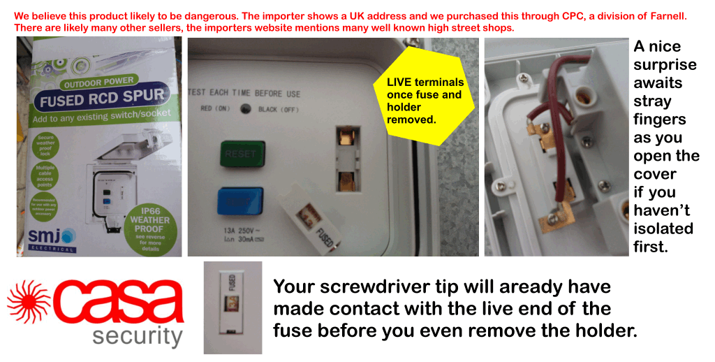

datadiffusion Posted October 23, 2014 Share Posted October 23, 2014 You don't need a tat mag code to get tat... Fecking lethal. But don't worry, they... ...strongly believe in British is best when it comes to product and packaging design. We work with leading designers to ensure our products are the best in their class. It's OK lads they also have ISO9001 and 14001 so can't be all bad! Needless to say we didn't use them. In case you're wondering its got our name on as I've also posted to twitter. So, I've decided to take my work back underground.... to stop it falling into the wrong hands Link to comment https://www.thesecurityinstaller.co.uk/community/topic/37589-lethal-chinese-from-cpc-smj-electrical/ Share on other sites More sharing options...
