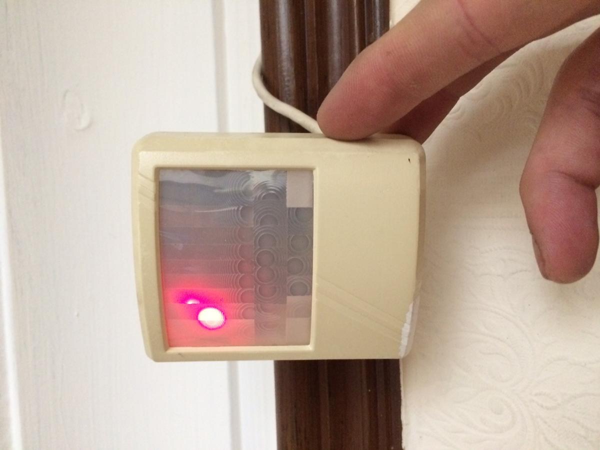

Madscanner Posted September 29, 2014 Share Posted September 29, 2014 Hi I have recently moved into rental accommodation on a 6-month lease. There is an alarm system in place but which is not (according to the letting agent) working. I downloaded the user guide for it, reset it to factory, added a new user PIN, and attempted to arm it. Not surprisingly, things didn't go according to plan, and I have 1 of the 4 zones showing an error when trying to arm the system. After setting the system to chime, I have identified the problematic zone. What I have is a PIR which reacts (red tell-tale light comes on) but does not chime (all the other sensors chime). I have two questions: 1 - does this indicate a problem with the sensor, or the circuit (i.e. wiring)? 2 - if it is the sensor, what replacement should I look for? If I'm swapping in a new sensor, I suspect I may need further advice/instruction, but will wait until later for that. I have attached an image of the relevant PIR. Regard The Madscanner Link to comment https://www.thesecurityinstaller.co.uk/community/topic/37443-omnicron-7000-issue/ Share on other sites More sharing options...
sixwheeledbeast Posted September 29, 2014 Share Posted September 29, 2014 It could be either the cable and/or the wiring. You need to test the cable and the sensor to diagnose further. Link to comment https://www.thesecurityinstaller.co.uk/community/topic/37443-omnicron-7000-issue/#findComment-401424 Share on other sites More sharing options...
norman Posted September 29, 2014 Share Posted September 29, 2014 Remove the wiring from the cct and replace with a link, if it cures it then it's the PIR or wiring. Also worth replacing the battery if it's over 4 years old. Then short the wiring at the PIR if that cures it then look at replacing the PIR. Nothing is foolproof to a sufficiently talented fool. Link to comment https://www.thesecurityinstaller.co.uk/community/topic/37443-omnicron-7000-issue/#findComment-401427 Share on other sites More sharing options...

Madscanner Posted September 29, 2014 Author Share Posted September 29, 2014 Thanks for the responses so far. No idea why the image of the PIR is out by 90 degrees, as the camera was upright and the image was correct on screen... Ah, well. At least it should demonstrate the age of the sensor... Norman - I assume you to mean disconnect the PIR wiring at the control box. If that is correct, what do I require as a link? Also, when you refer to battery, is that the backup battery that (I assume) is within the control panel? What sources are their for replacements these days? Another thought that has occured is that, given the age of this system, should I disable the zone, so that I can proceed to test the rest of the system? My thinking here is that its not worth spending money on it only to discover that there are other faults. Link to comment https://www.thesecurityinstaller.co.uk/community/topic/37443-omnicron-7000-issue/#findComment-401436 Share on other sites More sharing options...
