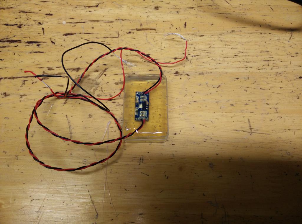

MrHappy Posted January 11, 2015 Author Share Posted January 11, 2015 project- 12v - 5v 50p ebay tat pcb, jumpers removed & flyleads soldiered on, tested then put in old iD biscuit box, gobbed over with hot melt glue glue has cured opaque but electronics now kick out 12v, bugger... Mr Veritas God Link to comment https://www.thesecurityinstaller.co.uk/community/topic/37402-resin/page/2/#findComment-407734 Share on other sites More sharing options...

al-yeti Posted January 11, 2015 Share Posted January 11, 2015 project- 12v - 5v 50p ebay tat pcb, jumpers removed & flyleads soldiered on, tested then put in old iD biscuit box, gobbed over with hot melt glue glue has cured opaque but electronics now kick out 12v, bugger... Not all resins protect electronics there some made to conduct electricity , packet would have said normally or data sheet Link to comment https://www.thesecurityinstaller.co.uk/community/topic/37402-resin/page/2/#findComment-407738 Share on other sites More sharing options...
datadiffusion Posted January 11, 2015 Share Posted January 11, 2015 I tried those said cheapo PCBs on the boat to run LED strings, all bust in the same manner you mentioned, they are just very badly designed / made I think. So, I've decided to take my work back underground.... to stop it falling into the wrong hands Link to comment https://www.thesecurityinstaller.co.uk/community/topic/37402-resin/page/2/#findComment-407742 Share on other sites More sharing options...
al-yeti Posted January 11, 2015 Share Posted January 11, 2015 I tried those said cheapo PCBs on the boat to run LED strings, all bust in the same manner you mentioned, they are just very badly designed / made I think. You just solder dodgy lol Link to comment https://www.thesecurityinstaller.co.uk/community/topic/37402-resin/page/2/#findComment-407749 Share on other sites More sharing options...
GalaxyGuy Posted January 11, 2015 Share Posted January 11, 2015 You're better with the LM2596 based DC-DC buck converter. Higher current capability and step down efficiency. Around £1 though. Link to comment https://www.thesecurityinstaller.co.uk/community/topic/37402-resin/page/2/#findComment-407778 Share on other sites More sharing options...
