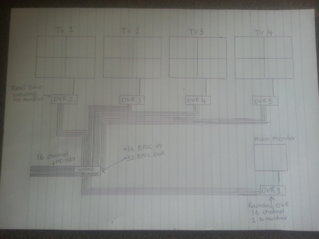

Ashley Tasker Posted June 29, 2014 Share Posted June 29, 2014 Hi im tring to connect 16 cameras to 4 32 inch tvs viewing 4 cameras on each screen so far the only way I have tjoight how to do it is the following way Link to comment https://www.thesecurityinstaller.co.uk/community/topic/36953-diy-pc-based-dvr/ Share on other sites More sharing options...
Ashley Tasker Posted June 29, 2014 Author Share Posted June 29, 2014 http://www.thesecurityinstaller.co.uk/community/gallery/image/586-1404044705425/ This is the plan Link to comment https://www.thesecurityinstaller.co.uk/community/topic/36953-diy-pc-based-dvr/#findComment-387229 Share on other sites More sharing options...
Lwillis Posted June 29, 2014 Share Posted June 29, 2014 Why not just use 4 quad switchers instead of DVRs. Cameras into DVR.> Loop through onto switchers> 1 coax between switcher and TVs Link to comment https://www.thesecurityinstaller.co.uk/community/topic/36953-diy-pc-based-dvr/#findComment-387231 Share on other sites More sharing options...
sixwheeledbeast Posted June 29, 2014 Share Posted June 29, 2014 Do you want HD images to the TV's? If so four 4 way HD-SDI DVR's would work better. I don't see why you need the huge DVR with the four little DVR's. Either one huge DVR with 4 programmable HDMI out's (If there's one available) or four 4 way DVR's with Ethernet to access each. Link to comment https://www.thesecurityinstaller.co.uk/community/topic/36953-diy-pc-based-dvr/#findComment-387239 Share on other sites More sharing options...
timmo66 Posted June 29, 2014 Share Posted June 29, 2014 You could always use a tv modulator if you have aerial sockets by the TVs or if they are smart tvs could the network be used to view all cameras from one DVR? Link to comment https://www.thesecurityinstaller.co.uk/community/topic/36953-diy-pc-based-dvr/#findComment-387241 Share on other sites More sharing options...
Lwillis Posted June 29, 2014 Share Posted June 29, 2014 Do you want HD images to the TV's? If so four 4 way HD-SDI DVR's would work better. I don't see why you need the huge DVR with the four little DVR's. Either one huge DVR with 4 programmable HDMI out's (If there's one available) or four 4 way DVR's with Ethernet to access each. Didn't see the HDSI . Link to comment https://www.thesecurityinstaller.co.uk/community/topic/36953-diy-pc-based-dvr/#findComment-387245 Share on other sites More sharing options...
sixwheeledbeast Posted June 29, 2014 Share Posted June 29, 2014 Didn't see the HDSI . It's alright, I didn't see the "main monitor". Still not quite sure I understand the application of it really. Why not have a larger screen on 16way? Link to comment https://www.thesecurityinstaller.co.uk/community/topic/36953-diy-pc-based-dvr/#findComment-387334 Share on other sites More sharing options...
al-yeti Posted June 30, 2014 Share Posted June 30, 2014 I suppose allot to do with location and perhaps being able to switch at each point, then still asbove one Dvr , a switch , or loop through monitors instead of tv's , lots of good ideas above! More detail perhaps needed Link to comment https://www.thesecurityinstaller.co.uk/community/topic/36953-diy-pc-based-dvr/#findComment-387351 Share on other sites More sharing options...
