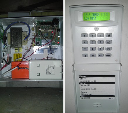

Westindieman Posted December 1, 2013 Share Posted December 1, 2013 Hello to all as I am new here. I was moving the alarm wires in my loft and was using a small screwdriver to open the cable holders. I accidentally punctured the wire and must have created a short as the siren went off for about 10-15 minutes wouldn't respond to anything I did on the security panel. When it stopped the panel was displaying this message and the PIRs and alarm is not working. Can anyone advise how I reset this or solve the error? I believe this is a Eurosec CP8L. Many Thanks Link to comment https://www.thesecurityinstaller.co.uk/community/topic/35739-check-low-batt-message/ Share on other sites More sharing options...
arfur mo Posted December 1, 2013 Share Posted December 1, 2013 you eill have likely blown a fuse in the panel, assumption made as the external siren only stopped after 15 minutes, if there is say more than 8 hours after your 'adventure' or a shorter time if the battery is old, it is running down. Given you have damaged the cable it is best to have it repaired properly, as if you might have skinned the cable it might short again, it could be subjected to corrosion at some later date. in any case you need a new fuse fitted inside the panel, as mains voltage is available in there, you must exercise extreme caution, or better use a competent alarm engineer for your own safety. If you think education is difficult, try being stupid!!!! Link to comment https://www.thesecurityinstaller.co.uk/community/topic/35739-check-low-batt-message/#findComment-357158 Share on other sites More sharing options...
james.wilson Posted December 1, 2013 Share Posted December 1, 2013 Id agree sounds like a fuse but you will need to repair whatever damage you did, also it may be elsewhere damaged and you have a cable timebomb securitywarehouse Security Supplies from Security Warehouse Trade Members please contact us for your TSI vetted trade discount. Link to comment https://www.thesecurityinstaller.co.uk/community/topic/35739-check-low-batt-message/#findComment-357165 Share on other sites More sharing options...

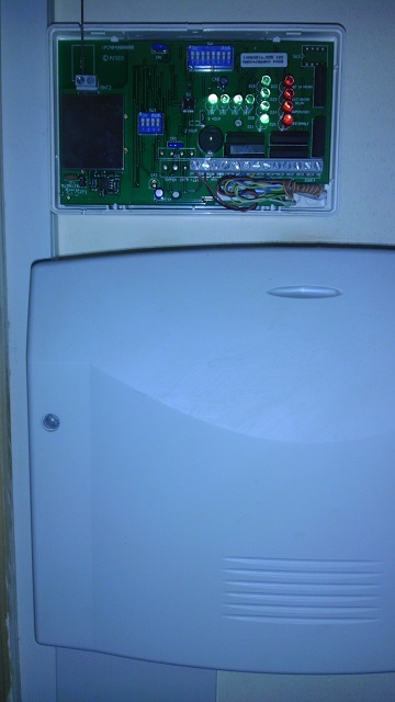

Alarm Protection Posted December 1, 2013 Share Posted December 1, 2013 That isn't the main panel in your photo. ! Link to comment https://www.thesecurityinstaller.co.uk/community/topic/35739-check-low-batt-message/#findComment-357241 Share on other sites More sharing options...
Westindieman Posted December 1, 2013 Author Share Posted December 1, 2013 That isn't the main panel in your photo. These are elsewhere in the house. The large box has a fuse below it but that is fine. The top box with the cover removed doesn't seem to have any power to it and I cant see a fuse in it. Thanks Link to comment https://www.thesecurityinstaller.co.uk/community/topic/35739-check-low-batt-message/#findComment-357338 Share on other sites More sharing options...

Alarm Protection Posted December 1, 2013 Share Posted December 1, 2013 If the top box doesn't have power going to it then check main panel after you have fixed wiring problem. Apart from that I would phone a local approved installer to fix the problem. As soon as you take the panel lid you might not be able to re set the system. You have a wired system with extra wireless detectors? Tbh just call a local to fix this as imo this cannot be fixed by a DIY. ! Link to comment https://www.thesecurityinstaller.co.uk/community/topic/35739-check-low-batt-message/#findComment-357348 Share on other sites More sharing options...
