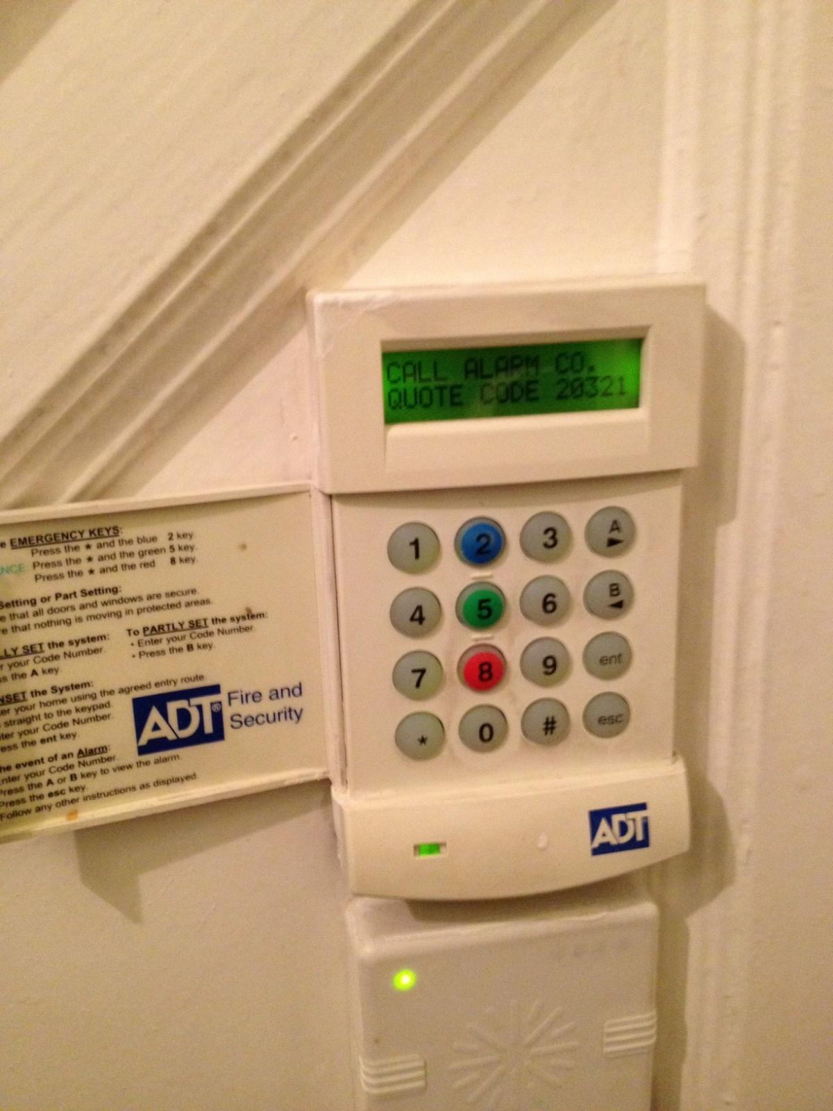

lumia Posted March 24, 2012 Share Posted March 24, 2012 hi i have a adt alarm not sure about the model, but the alarm has gone off because the mrs came through the back door so it now says intruder kitchen on the control panel, its telling me to call and quote code 20321, and as i am not a customer with adt i have to pay something along the lines of £90 or become a memeber again. can anyone please help? i have uploaded photos of what the message i am recieving Link to comment https://www.thesecurityinstaller.co.uk/community/topic/32752-adt-alarm-error/ Share on other sites More sharing options...
MrHappy Posted March 24, 2012 Share Posted March 24, 2012 I assume galaxy 16 ? if adt are too dear for you ask a smaller co. ? Mr Veritas God Link to comment https://www.thesecurityinstaller.co.uk/community/topic/32752-adt-alarm-error/#findComment-282531 Share on other sites More sharing options...
PeterJames Posted March 24, 2012 Share Posted March 24, 2012 There is only two ways to reset the alarm 1. You get a reset code from ADT no one else can do it as they wont have the seed code 2. You get a local co in to default and reprogram it under noncontract we would cost more than £90 but then again once reprogrammed it wont need reseting when your wife goes through the wrong door Link to comment https://www.thesecurityinstaller.co.uk/community/topic/32752-adt-alarm-error/#findComment-282534 Share on other sites More sharing options...

lumia Posted March 24, 2012 Author Share Posted March 24, 2012 oh right i thought it might of been a box standard reset code? which someone might have or no a way around it Link to comment https://www.thesecurityinstaller.co.uk/community/topic/32752-adt-alarm-error/#findComment-282536 Share on other sites More sharing options...
Rulland Posted March 24, 2012 Share Posted March 24, 2012 oh right i thought it might of been a box standard reset code? which someone might have or no a way around it Unfortunately it's not as simple as that, it requires an anticode reset via the installer-ADT, or a default/reprogram via another alarm company, fortunately I dont penalise customers who make the simple mistake of using the wrong door!. Link to comment https://www.thesecurityinstaller.co.uk/community/topic/32752-adt-alarm-error/#findComment-282537 Share on other sites More sharing options...
lumia Posted March 24, 2012 Author Share Posted March 24, 2012 Unfortunately it's not as simple as that, it requires an anticode reset via the installer-AD(PEE), or a default/reprogram via another alarm company, fortunately I dont penalise customers who make the simple mistake of using the wrong door!. ah well think there no alternative but to give adt or might have a look at local alarm company who might be able to sort it out cheaper, but thats me told for using the wrong door!! Link to comment https://www.thesecurityinstaller.co.uk/community/topic/32752-adt-alarm-error/#findComment-282539 Share on other sites More sharing options...
MrHappy Posted March 24, 2012 Share Posted March 24, 2012 fortunately I dont penalise customers who make the simple mistake of using the wrong door!. I assume Its on "engineer " reset due to being a (former) monitored system, but your free to think that compliance with a standard is being "penalised" because they liable to to refuse an anticode reset to a system which provide no income is wrong... Mr Veritas God Link to comment https://www.thesecurityinstaller.co.uk/community/topic/32752-adt-alarm-error/#findComment-282540 Share on other sites More sharing options...
lumia Posted March 25, 2012 Author Share Posted March 25, 2012 i was tied in a 3 year contract a few years ago with them but just cancelled after that as the system i had was old etc all i need is 1 simple code and well basically its a con just to pay in the excess of £100 for a 4 digit code which they told me will be done within seconds Link to comment https://www.thesecurityinstaller.co.uk/community/topic/32752-adt-alarm-error/#findComment-282541 Share on other sites More sharing options...
