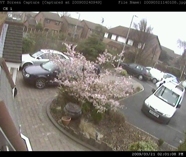

Johnny Posted March 25, 2009 Author Share Posted March 25, 2009 He has a GJD pir on the front door so when it bleeps he can turn to the av channel and view. When I put images to the usb then to the laptop it not great but ok for a cheap system. Here is a pic. The camera is not in the correct position yet ............ Link to comment https://www.thesecurityinstaller.co.uk/community/topic/27814-info-please/#findComment-230794 Share on other sites More sharing options...
