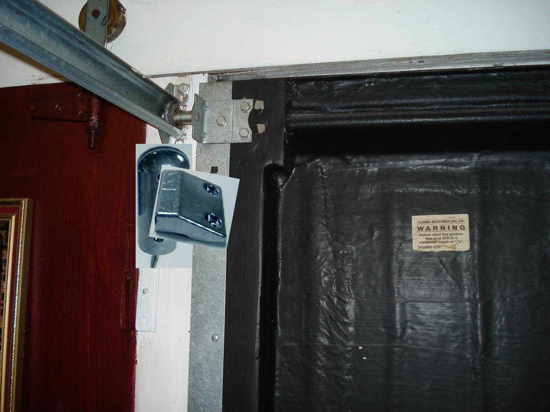

james.wilson Posted February 16, 2009 Share Posted February 16, 2009 lol OP idealy you want a roller shutter or heavy duty contact at the base of the door. Alternativly a roller shutter / hd type right at the top just ensure the magnet and or contact wont affect any part of the door on open/close securitywarehouse Security Supplies from Security Warehouse Trade Members please contact us for your TSI vetted trade discount. Link to comment https://www.thesecurityinstaller.co.uk/community/topic/26993-where-how-shall-i-mount-contact-on-this-garage/page/2/#findComment-224967 Share on other sites More sharing options...

virdi Posted February 16, 2009 Author Share Posted February 16, 2009 How would I mount a contact to metal or fibre glass? Is there a super strong glue anyone could recommend? Link to comment https://www.thesecurityinstaller.co.uk/community/topic/26993-where-how-shall-i-mount-contact-on-this-garage/page/2/#findComment-224978 Share on other sites More sharing options...
james.wilson Posted February 16, 2009 Share Posted February 16, 2009 no dont use glue ever for contacts...it wont last you will need to bolt it on with coach type bolts, ie domed head. securitywarehouse Security Supplies from Security Warehouse Trade Members please contact us for your TSI vetted trade discount. Link to comment https://www.thesecurityinstaller.co.uk/community/topic/26993-where-how-shall-i-mount-contact-on-this-garage/page/2/#findComment-224983 Share on other sites More sharing options...
virdi Posted February 16, 2009 Author Share Posted February 16, 2009 sorry - what is a Coach bolt? Link to comment https://www.thesecurityinstaller.co.uk/community/topic/26993-where-how-shall-i-mount-contact-on-this-garage/page/2/#findComment-224987 Share on other sites More sharing options...
Guest old-hand Posted February 16, 2009 Share Posted February 16, 2009 sorry - what is a Coach bolt? Domed head, no way for a screwdriver to be used. Bolted down from underneath for security. And use threadloc. Link to comment https://www.thesecurityinstaller.co.uk/community/topic/26993-where-how-shall-i-mount-contact-on-this-garage/page/2/#findComment-224988 Share on other sites More sharing options...
james.wilson Posted February 16, 2009 Share Posted February 16, 2009 sorry - what is a Coach bolt? please dont take this the wrong way... but are you sure you want to attempt this job? see attached securitywarehouse Security Supplies from Security Warehouse Trade Members please contact us for your TSI vetted trade discount. Link to comment https://www.thesecurityinstaller.co.uk/community/topic/26993-where-how-shall-i-mount-contact-on-this-garage/page/2/#findComment-224989 Share on other sites More sharing options...
virdi Posted February 16, 2009 Author Share Posted February 16, 2009 please dont take this the wrong way... but are you sure you want to attempt this job?see attached Thanks It's too late - I've already started - lol Well I've run some of the cables and that's about it.... That's why I've asked for help on here, as I wasn't too sure what would be the best way to mount a contact on this Garage door. I can't really use a bolt through that metal, as it's only about 5mm thick - and if a screw or bolt was sticking out on the other side - The garage door would not shut, as it would hit the frame - I'll try to take some better pics tomorrow and explain. aahhh! - Idea - doh!! - I could put the bolt in from the other side - Hence the nut could screw on frm the inside You know how these heavy duty metal contacts come pre-wired - What's the best / professional way to join them - to the cables coming from the panel? Link to comment https://www.thesecurityinstaller.co.uk/community/topic/26993-where-how-shall-i-mount-contact-on-this-garage/page/2/#findComment-224996 Share on other sites More sharing options...
