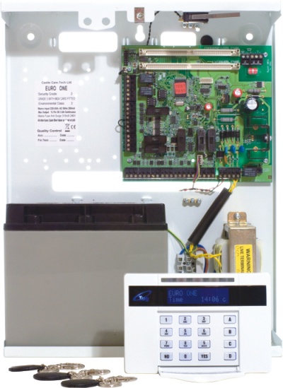

billythebellbox Posted June 10, 2008 Share Posted June 10, 2008 I'm not totally clued up yet, but apparently there is an optional communications card to allow for external engineer access and pc connectiviity, but this is not necessary for outgoing sms and call centre calls. ignore the keypad, right does your pcb look like this? De Do Do Do, De Da Da Da. De Do Do Do, De Da Da Da Link to comment https://www.thesecurityinstaller.co.uk/community/topic/23573-telephone-wiring-advice-needed/page/6/#findComment-200838 Share on other sites More sharing options...
HoofHearted Posted June 10, 2008 Author Share Posted June 10, 2008 Here's my board. It's a little different. Interestingly, the AT microswitch is on the PCB. The lid for the case doesn't come anywhere near it. I had to glue a 30mm piece of wood on the inside of the lid. Link to comment https://www.thesecurityinstaller.co.uk/community/topic/23573-telephone-wiring-advice-needed/page/6/#findComment-200841 Share on other sites More sharing options...
