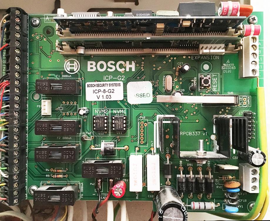

Actually I think the dialler is on the main board and the slot-in card is RS232, but I never got it to work.
Castle Caretech Compatibility
A memory expansion card and a telephone dialer card. I think that's what you just said.
Let me ask the question a little differently..... Assuming that the supply voltage is the same, would it be safe to try my existing zone expanders with a new panel. I'm an IT manager. So I know about networking. I think it will either work or it won't. In my experience an incompatible communication protocol isn't going to kill anything.

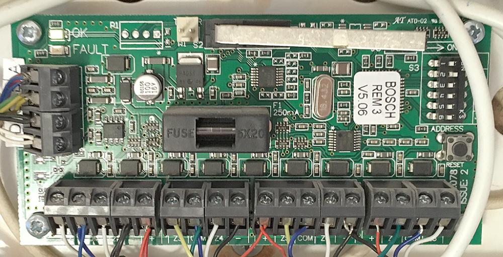

On the 4 way connector, A and B are the power supply. C and D are the RS485.
A good many years ago I installed a Bosch Abacus Evolution Alarm panel and 3 zone expanders. Not long afterwards the series was discontinued. I was told subsequently, that actually this a Castle Caretech panel which had been re-badged by Bosch. I bought some Castle Caretech prox tags and I was pleased to find that they worked. I want replace my panel now, possibly with the Castle Caretech Euro 46. Is there any chance that my existing zone expanders will be compatible?
