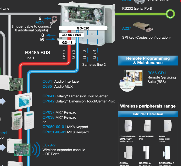

  6. Well... I just looked ones again in to Honeywell Galaxy Dimension Architecture-Chart and it seems that all those components are in one picture. I really hope that it's true. And RF Portal seems that is more newer device and designed to work with newer Galaxy Flex type of systems? Lets see what experts will say. Are you saying about a little bit of DIY to merry active beams with Honeywell's RF door contact transport? or? Thank you
  7. Hi, Just trying to pick the right components. I have got already Honeywell Dimension Galaxy 48 and C079-2 RF-RIO and I'm pretty sure that DT8M wireless PIR will work with it, but I thought I will ask before I buy those. Idea is to build temporary scaffold alarm system. So question no.2: Is it the bast what I can shoes from Honeywell dual-tec wireless PIRs for this situation? Sure not counting the fact that they probably not outdoor rated, but I will make it up something. I'm thinking to put it in 'pet mode', so in case if foxes jumping over the fence or cats. I will put beam away from bushes or trees I think this will do the job? My not professional thinking dual-tech is a good choice too? Additional question would be: There is no option in my situation for wireless sounder? But I though its fine to pull a one wire. I'm not security professional so I allowed myself to ask such a question here. ?It's OK if you answer with little bit of sarcasm, but please no answers like: "Leave it for professionals" or "I need to use outdoor grade cable for sounder". ?

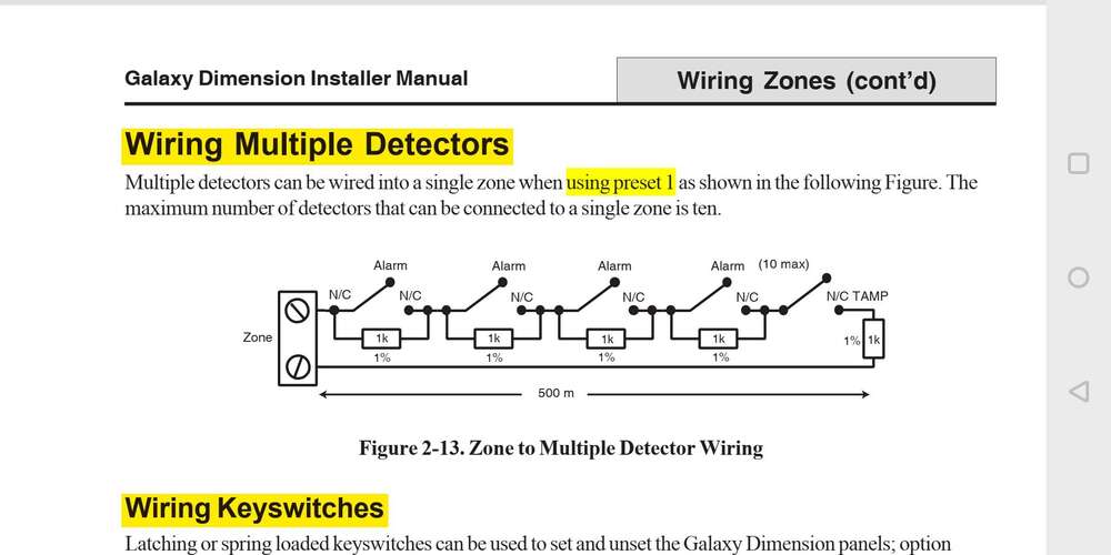

  14. Can we expand a little bit on some of the things that weren't mentioned by James? 2. Wiring multiple detectors. 'Preset 1' (in the screenshot) is this relates to resistance values Option 01 - 1k from the table 2-7? At the same time, this means that it's Double-balanced type of line? 4. Push to set. I bit doubt bout how the scenario would look like in this configuration? If the button is pushed and all zones in a safe state then system will be set? And if this is true, then, in the same way, the system will be unset just while pushing the same button? How we can call this system safe if anyone can unset the system by clicking the button? Or any other factors must be met? Soon I will test this scenario myself but would be nice to know what to expect instead guessing the correct results. 5. In both tables 2-7 and 2-8, there are two lines named Low Resistance and High Resistance. What this for? Why those are even mentioned? I'm right with saying that is value ranges to avoid false results/alarms?

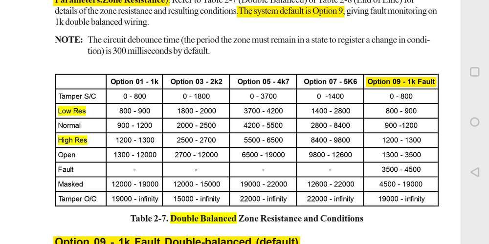

  16. Hi, I have got some questions while reading the manual. As relatively new to this, I need help to understand the following below. All from Honeywell Galaxy Dimension Installer manual pdf here,**link removed** pages 2-14 through 2-16 (until the outputs) 1. Zone wiring types. Fault double-balanced vs. Fault end-of-line Why those two types exist, or brief prehistory? When/why one is used vs another? The only difference I have spotted is that Alarm contacts have a resistor in parallel. Anything to note? 2. Wiring multiple detectors This option has the capability to belong as 500m line instead 100m as in previous examples. Where the hidden point is here for me to understand? There are no different settings to be set to use this option. Only the thing is mentioned in the description that is must be Preset 1. What is preset? And in this configuration, no Fault and/or Anti-Mask detection can't be used? Just because zone won't understand what's happening if multiple detectors activated? Correct? But still, need clarification if this belongs to double-balanced or end-of-line condition, or...? 3. What is Fault detection? I understand what is Alarm, what is Temper and what is Anti-Mask. Not quite sure about the Fault. Is this available on certain sensors only? 4. Key-switches and terminator buttons. So the idea of key-switch is to use one zone and convert it as a control to set the system without fob or keypad just with connecting wires together with the right resistance? Ok, I understand this. This can be useful when integrating the system with other smart things. Now the push-set is a similar thing just not a switch but button? Also could be used to integrate with another system via toggle relay. Where or how else it can be used? Thanks in advance.

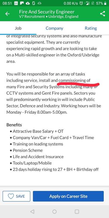

  24. Commissioning, like here in this ad:
  25. Hi, I know this is maybe just too obvious for old security wolfs but to taste the real meaning of a commissioning engineer, can you describe your day as a commissioning engineer? What exactly have you done, the tasks and how you explain the time you spend, please? Today or yesterday, or maybe you have more 'tasty' examples from the past? Please go deep in details or technical as you wish. As not professional, I would like to see the colour palette and to feet the taste of it. Thank you very much in advance.
