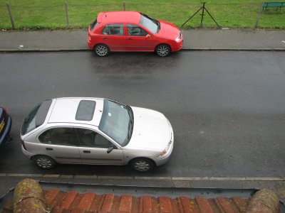

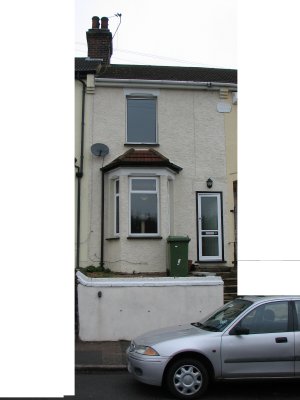

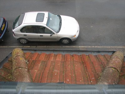

Guest matopia Posted January 2, 2006 Share Posted January 2, 2006 A good standard camera will generally give a better image than a good dome camera - if you go for dome due to fear of vandalism you will need to ensure that you get a day/night version or you will not be able to see anything at night. Thank you for your comments. I am now undecided. Let me approach this another way. Photo1: Here is a view from my window (looking down where my car would be parked). The little roof is on top of a small bay window, which is my lounge window. All I want the camera to see is the pavement and/or the little patch of land in front of my window as well as watch the car park below (where that silver car is parked) and/or the red car on the other side of the road. Photo2: Is where I park when I can't park outside my house. And so, this was the reason I was wanting a camera that could cover the range. Photo3: is a view from the other side of the road where I would normally park (as in photo2). Where would be the best place to put the camera(s) and how high up should it be? Will I be needing more than one camera to cover what I want covered (pavement/car and/or other side of road). I am thinking yes... and knowing what you know now, do I need a dome (day/night) camera or the Samsung 520 or something else? Sorry to be a pain... , Mike Link to comment https://www.thesecurityinstaller.co.uk/community/topic/8755-hi-from-kent-cctv-advice/page/2/#findComment-81189 Share on other sites More sharing options...
Guest Raymond Posted January 2, 2006 Share Posted January 2, 2006 Where would be the best place to put the camera(s) and how high up should it be? Without a doubt, I'd locate the camera under the eaves (to provide protection from rain) and the field of view wuold be reasonable enough to covver across the street if you're parket there. One of the cameras featured earlier, with inbuild IR array round the lens would provide illumination and any spill would reflect off the building front. You'll just have to route the wiresnto the loft space then down to your recorder. Link to comment https://www.thesecurityinstaller.co.uk/community/topic/8755-hi-from-kent-cctv-advice/page/2/#findComment-81193 Share on other sites More sharing options...
norman Posted January 2, 2006 Share Posted January 2, 2006 I would mount the camera lower down as to capture some facial features, high up and you will get a good coverage but only of the tops of heads. Nothing is foolproof to a sufficiently talented fool. Link to comment https://www.thesecurityinstaller.co.uk/community/topic/8755-hi-from-kent-cctv-advice/page/2/#findComment-81194 Share on other sites More sharing options...

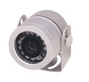

Guest matopia Posted January 2, 2006 Share Posted January 2, 2006 Without a doubt, I'd locate the camera under the eaves (to provide protection from rain) and the field of view wuold be reasonable enough to covver across the street if you're parket there. One of the cameras featured earlier, with inbuild IR array round the lens would provide illumination and any spill would reflect off the building front. You'll just have to route the wiresnto the loft space then down to your recorder. You mean something like this (taken from above)... I would mount the camera lower down as to capture some facial features, high up and you will get a good coverage but only of the tops of heads. Does anyone have footage of what to expect from a particular camera at a defined height. (I have seen an example of footage for the (IR camera) and according to the author it was not great. As long as it stops these vandals damaging my property or makes them aware that they are being monitored, then mission accomplished Mr Bond! I suppose higher up near/under the eves will capture heads and survey the area I want to watch, and perhaps a 2nd camera (spy/covert camera) well hidden can be lower to capture face features... This is going to cost money hey! Link to comment https://www.thesecurityinstaller.co.uk/community/topic/8755-hi-from-kent-cctv-advice/page/2/#findComment-81201 Share on other sites More sharing options...
Guest matopia Posted January 2, 2006 Share Posted January 2, 2006 What does 0 LUX with IR mean? What sort of MINIMUM LUX should I be looking for in a camera? What is radient distance of 10 mean? I've been looking at the above Beam Spread and 35 degrees is that good or bad? How can one get that increased and does that mean radient distance needs to increase or decrease? I had a look at another dome camera and it mentioned it had Built in Vari-Focal 3.5-8mm Lens apposed to what? What is the advantage of Vari Focal? Can this be adjusted remotely at the DVR? , Mike Link to comment https://www.thesecurityinstaller.co.uk/community/topic/8755-hi-from-kent-cctv-advice/page/2/#findComment-81213 Share on other sites More sharing options...
Guest rjbsec Posted January 2, 2006 Share Posted January 2, 2006 A day/night camera will allow you to see colour at day and mono at night, colour produces a much better degree of clarity for identification. You will need suitable light, be it sensor operated standard lighting or some form of infrared lighting. A camera fitted at lower level, say about the height of your satellite dish, will provide the best "capture" due to the steep angle down to the point where your car will be parked. The camera you display in your post has a very flimsy bracket and I would not use it if I lived in your house, I would probably opt for one or more vandal-resist day/night dome cameras with onboard infrared LED's for minimal illumination, though there aren't many around with the infrared LED's. http://www.digitalvideos.co.uk/productimag...RVFPRO-spec.pdf Link to comment https://www.thesecurityinstaller.co.uk/community/topic/8755-hi-from-kent-cctv-advice/page/2/#findComment-81214 Share on other sites More sharing options...
Guest matopia Posted January 2, 2006 Share Posted January 2, 2006 A day/night camera will allow you to see colour at day and mono at night, colour produces a much better degree of clarity for identification. You will need suitable light, be it sensor operated standard lighting or some form of infrared lighting.A camera fitted at lower level, say about the height of your satellite dish, will provide the best "capture" due to the steep angle down to the point where your car will be parked. The camera you display in your post has a very flimsy bracket and I would not use it if I lived in your house, I would probably opt for one or more vandal-resist day/night dome cameras with onboard infrared LED's for minimal illumination, though there aren't many around with the infrared LED's. http://www.digitalvideos.co.uk/productimag...RVFPRO-spec.pdf Cool, thanks for the advice... I think I am going to use dome cameras as you suggest. Just one question. I understand I need extra lighting, but what are those LED's surrounding the lense in that camera you have posted? Do they not offer light at night? Link to comment https://www.thesecurityinstaller.co.uk/community/topic/8755-hi-from-kent-cctv-advice/page/2/#findComment-81224 Share on other sites More sharing options...
