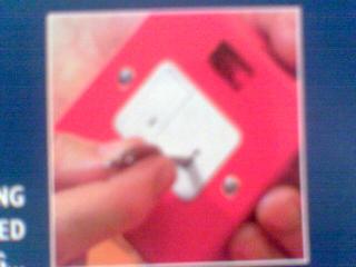

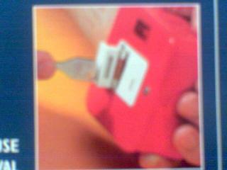

Guest Posted April 4, 2005 Share Posted April 4, 2005 Ok then, for the purposes of the following live conductors are phase and neutral, excluding earth. Earth should never be switched, it doesn't get included in the term 'all poles', and non-ameteurs know this. Isolation is switching in all live conductors, (phase and neutral), earth is to be maintained at all times and should never be switched. Doesn't matter in which context it is, that's isolation. A single pole switch of any variety, whether it's a light switch or unswitched spur, is classed as a functional switch and is required to be fitted to phase conductors. Single pole devices should never be installed in neutral conductors. Neutral conductors should only be switched as part of a multipole isolator switching all live conductors. Technically, alarm panels should be isolated with DP isolators. It's just convention that says not. Contactum do a DP switched fused spur with key operated switch and fuse removal for alarm panels and the like. Link to comment https://www.thesecurityinstaller.co.uk/community/topic/5634-tough-job-mi-cable-etc/page/3/#findComment-46810 Share on other sites More sharing options...
datadiffusion Posted April 4, 2005 Share Posted April 4, 2005 Contactum do a DP switched fused spur with key operated switch and fuse removal for alarm panels and the like. 46810[/snapback] Hmm, interesting, but I'm assuming its really just a 'factory assembled' product using their grid system? Dont know much about Contactum. Presumably you could make your own using MK grids, never thought of doing that. Stu. So, I've decided to take my work back underground.... to stop it falling into the wrong hands Link to comment https://www.thesecurityinstaller.co.uk/community/topic/5634-tough-job-mi-cable-etc/page/3/#findComment-46833 Share on other sites More sharing options...
Guest Posted April 4, 2005 Share Posted April 4, 2005 Hmm, interesting, but I'm assuming its really just a 'factory assembled' product using their grid system? 46833[/snapback] Nope, completely one off product. Designed for the job. Unforunately, the Contactum website is useless, and I'm too lazy to go and look in the contactum catalogue for the part number, maybe later. Here we go, for a start 3467, 3469. Link to comment https://www.thesecurityinstaller.co.uk/community/topic/5634-tough-job-mi-cable-etc/page/3/#findComment-46837 Share on other sites More sharing options...

datadiffusion Posted April 5, 2005 Share Posted April 5, 2005 Nope, completely one off product. Designed for the job. Unforunately, the Contactum website is useless, and I'm too lazy to go and look in the contactum catalogue for the part number, maybe later. Here we go, for a start 3467, 3469. 46837[/snapback] Your not kidding, website slow as you like and then that product isnt listed (checked both 'switched' and 'unswitched' spurs and searched just to be sure!) Stu. So, I've decided to take my work back underground.... to stop it falling into the wrong hands Link to comment https://www.thesecurityinstaller.co.uk/community/topic/5634-tough-job-mi-cable-etc/page/3/#findComment-47025 Share on other sites More sharing options...
Guest Posted April 5, 2005 Share Posted April 5, 2005 Your not kidding, website slow as you like and then that product isnt listed (checked both 'switched' and 'unswitched' spurs and searched just to be sure!) 47025[/snapback] I could scan the proper pages in if I had the motivation! Meanwhile, here's some ropey photo's of the relevant unit! Also available in white. Link to comment https://www.thesecurityinstaller.co.uk/community/topic/5634-tough-job-mi-cable-etc/page/3/#findComment-47038 Share on other sites More sharing options...
