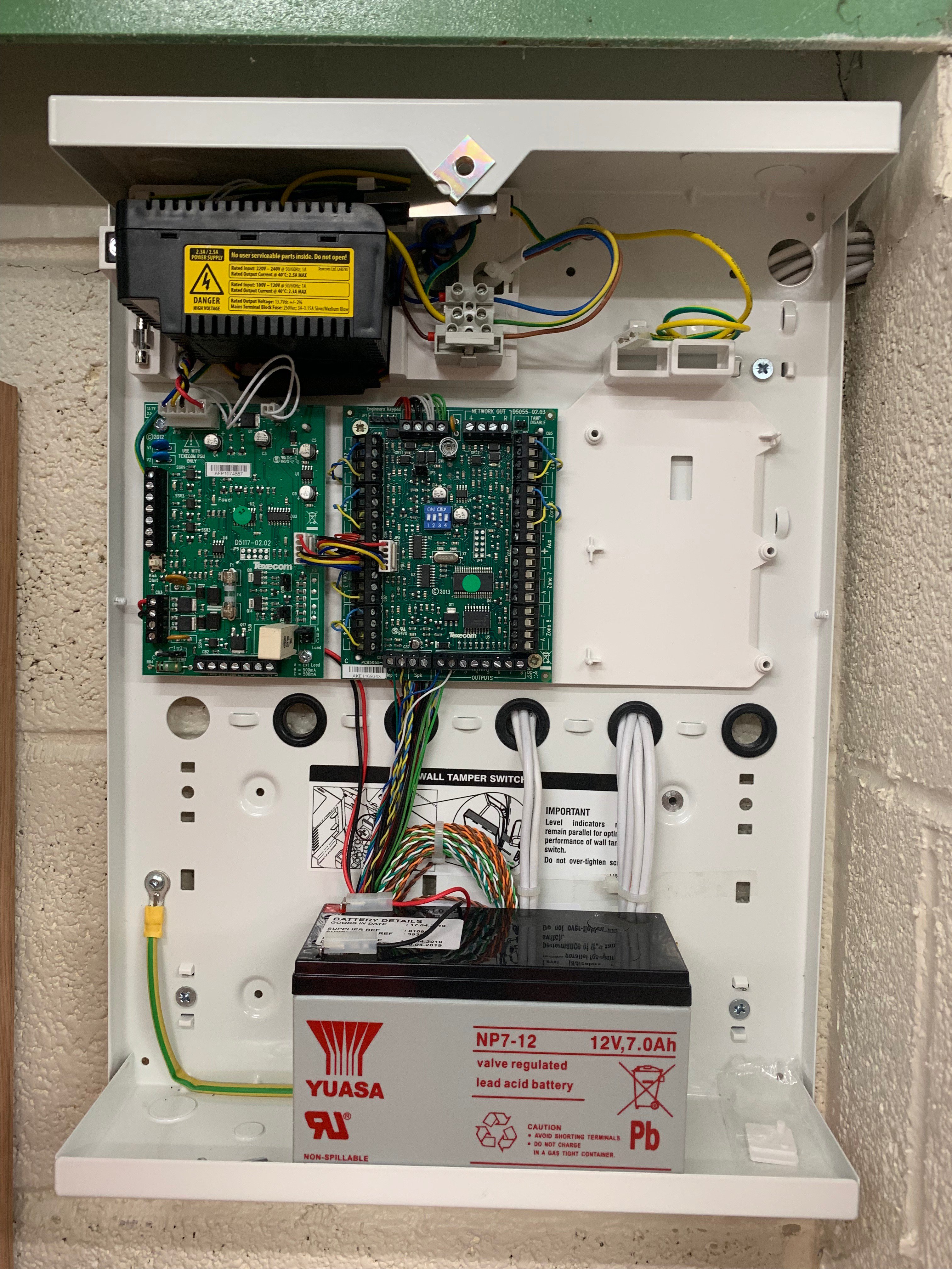

5 minutes ago, James R said:
How can you tell?
circuits ain't paired

5 minutes ago, MrHappy said:
D9MCzaoX4AYV3J8?format=jpg&name=4096x409
(pse's work picture from twitter)
Ccts aren't paired? What do you mean by that? BTW sweet looking install. Grommets and everything... Show off lol?
An EOL circuit is 2 wires, these have been twisted together to make pair of cables
I'd use a drill, with a hook in the chuck
The pic is not my work but that of @PSE
mine look better with the lid on ?
Drill with a hook to twist the cables--like that... Your not taking the piss are you? ?

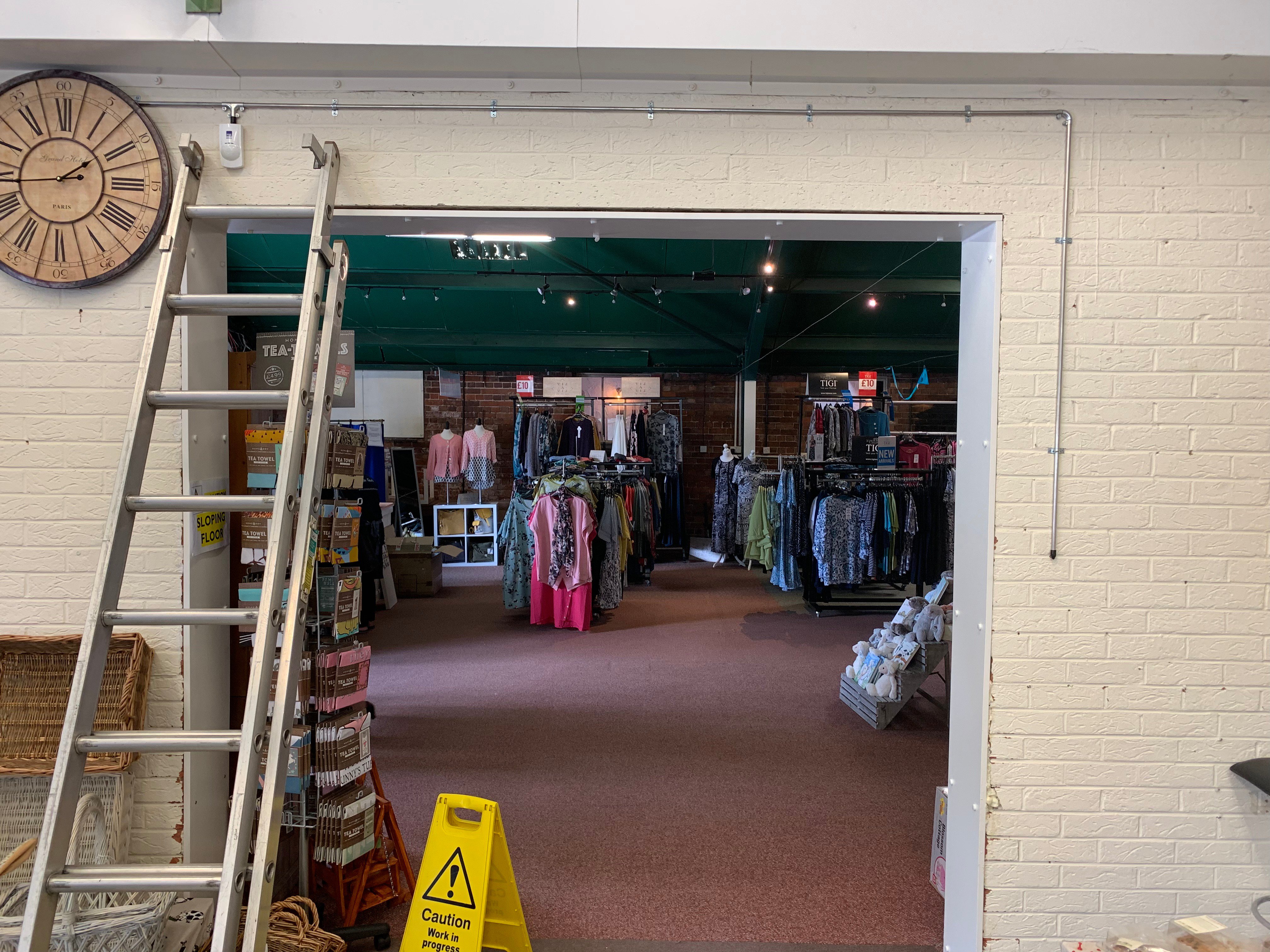

D9MCccgXYAEImKZ?format=jpg&name=4096x409
this is another pic from the same install, alloy tube
it quite unlikely anyone without an alarm trade background will tube & enter the tube by drilling into the back of it? (
That looks good - as a background as a sparks I would have just used 20mm galv conduit - is that stuff easier to install? Obvs galv conduit is a c*nt
