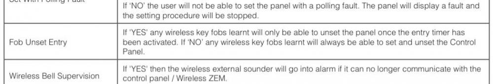

On 16/01/2019 at 13:15, Amps said:
Check ‘System Options’
Internet beers for this man!
Thank you very much @Amps - that was the fix! The panel was set to YES, switched to NO and all is well.
