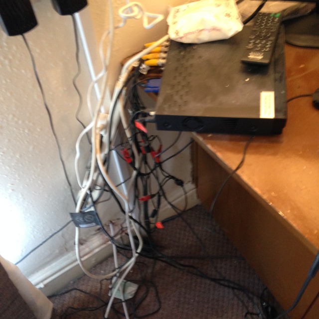

been on many CCTV installs where the client has said he or she can get cameras for 20-30 pound !
with the internet as it is now and with end user able to buy cheap kits its becoming more regular. I have seen some right bodge jobs with people trying to put kit in. after the correct engineers have finished though there is no comparison , from bnc or rg45 plugs a proper job is a proper job.
