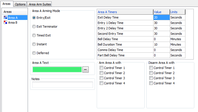

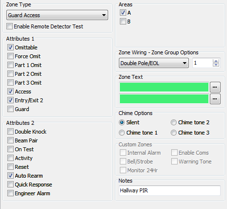

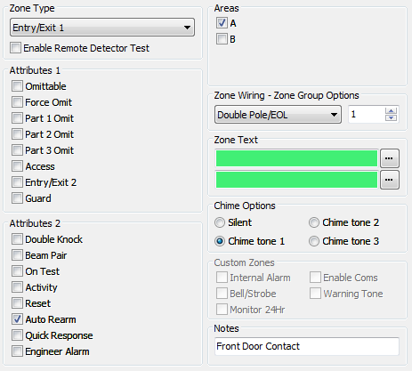

jkno Posted June 29, 2015 Share Posted June 29, 2015 I was using Arming Mode: Timed Exit. Yesterday I finally got round to adding the door contact to the main entrance and re-reprogrammed the alarm to Arming Mode: Entry/Exit. My issue comes down to the part 1 omit (night time/sleep). The alarm sets fine but when I walk downstairs the Hallway PIR (Zone 2) activates and the sounders goes off. My confusion is that I want the alarm to go off if Zone 2 is triggered without the entry/exit being active in all states but a part set which seems reasonable and looks possible from the manual but I'm sure I've got my config wrong. Zone 1 - Area A - Front Door (Contact) - Entry/Exit 1 Zone 2 - Area A - Hallway (PIR) - Guard Access - Access - Is this needed? Wintex auto selects it for Guard Access Zones - Entry/Exit 2 -Is this needed? Wintex auto selects it for Guard Access Zones Zone 5 - Area A - Landing (PIR) - Part 1 Omit Link to comment https://www.thesecurityinstaller.co.uk/community/topic/38694-texecom-premier-elite-part-arm-entryexit/ Share on other sites More sharing options...
jkno Posted June 29, 2015 Author Share Posted June 29, 2015 Managed to sort the issue it seems that I needed entry/exit 2 enabled under a guard access zone on the zone 2 PIR for the part set to allow disarm without the sounders going off. Link to comment https://www.thesecurityinstaller.co.uk/community/topic/38694-texecom-premier-elite-part-arm-entryexit/#findComment-422405 Share on other sites More sharing options...
secureiam Posted June 29, 2015 Share Posted June 29, 2015 sounds like your fiddling as the guard access zone is set up that way at default and you have turned the attribute off initially and putting it back to the default setting made it function as it was intended. Link to comment https://www.thesecurityinstaller.co.uk/community/topic/38694-texecom-premier-elite-part-arm-entryexit/#findComment-422485 Share on other sites More sharing options...

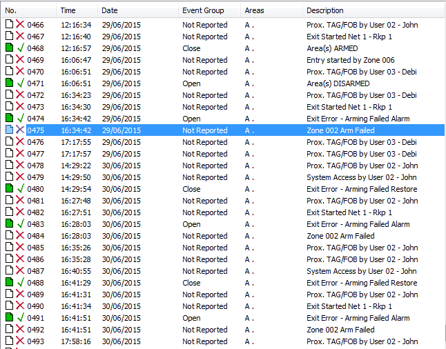

jkno Posted June 30, 2015 Author Share Posted June 30, 2015 I've still not got this quite right. Both the part and the full access was working perfectly, now I keep getting a failed set without changing and config. Link to comment https://www.thesecurityinstaller.co.uk/community/topic/38694-texecom-premier-elite-part-arm-entryexit/#findComment-422623 Share on other sites More sharing options...
sixwheeledbeast Posted June 30, 2015 Share Posted June 30, 2015 Looks like your triggering the Hall PIR while it's arming. You could do with some zone text, log would be easier to read. Link to comment https://www.thesecurityinstaller.co.uk/community/topic/38694-texecom-premier-elite-part-arm-entryexit/#findComment-422624 Share on other sites More sharing options...
jkno Posted June 30, 2015 Author Share Posted June 30, 2015 There's an exit settle time of 8 seconds shouldn't this prevent the the PIR trigger from causing a fault? Link to comment https://www.thesecurityinstaller.co.uk/community/topic/38694-texecom-premier-elite-part-arm-entryexit/#findComment-422626 Share on other sites More sharing options...
sixwheeledbeast Posted June 30, 2015 Share Posted June 30, 2015 Depends on the PIR and if you are clearing the area quick enough. Link to comment https://www.thesecurityinstaller.co.uk/community/topic/38694-texecom-premier-elite-part-arm-entryexit/#findComment-422629 Share on other sites More sharing options...
al-yeti Posted June 30, 2015 Share Posted June 30, 2015 8seconds to little for some pir need to increase fail set time Link to comment https://www.thesecurityinstaller.co.uk/community/topic/38694-texecom-premier-elite-part-arm-entryexit/#findComment-422644 Share on other sites More sharing options...
jkno Posted July 1, 2015 Author Share Posted July 1, 2015 I've increased it to 15 seconds will find out when I get home if it's worked. The part 1 set isn't triggering the entry at the moment when I go downstairs (used to pick me up after a few steps) I walked downstairs in full visibility of the sensor this morning and waited a good 5-10 seconds in front of the keypad without it triggering. I'm using Texecom Premier Compact QD sensors. Couldn't justify anti masking for home. Either there's gremlins in the system or I'm the gremlin. Link to comment https://www.thesecurityinstaller.co.uk/community/topic/38694-texecom-premier-elite-part-arm-entryexit/#findComment-422655 Share on other sites More sharing options...
