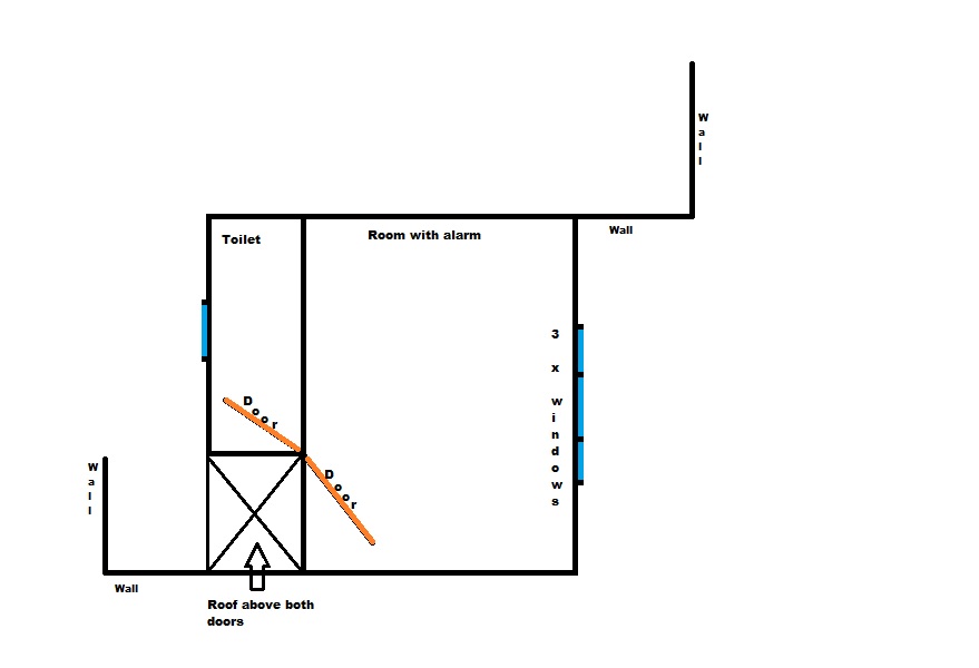

SouthernStar* Posted August 10, 2014 Share Posted August 10, 2014 Hey everybody i just want to introduce myself first of all, im not from UK but im in desperate need of some help with this DIY system, any help will be very appreciated. So i am trying to secure a cottage in the back garden. See picture below As for the alarm im going with this pcb here Here , then ill add a standard 12v sealed lead acid battery maybe 12v x 1.3 AMP, Ill be geting a 220V to 16 VAC @ 1amp adapter to run the pcb board & a 12v 110db siren. I already have a 4 button & 1 button remote to program it in. The PIR motion sensors which cost about 8 € each they have a 12m range with a 160 degree angle according to its specs ( link : Here ) this is another one that costs about 10 € ( Link : Here ) i also have a flood light that i could take the sensor off and place that one outside by the two windows. As for the PIR's i wanted to run them outside but i dont think that will be a wise option at all ? So i thought of putting one inside protecting the windows & then out sitting outside under the roof by the two doors in the picture. If you have any other suggestions please give some input. Would you think the PIR's i listed would detect even a slight movement of the window opening ? I would prefer if it goes if before they are already standing inside the cottage, ill be really happy if i can get some feedback. I have a computer with two webcams would could act as surveillance and motion detection with notification, i was even thinking of putting the one webcam outside by the two doors with a small led attached, then doing the same outside but im open to suggestions about what the best, secure, failsafe method is. Thank You all : ) Link to comment https://www.thesecurityinstaller.co.uk/community/topic/37200-help-needed-with-diy-2-zone-alarm/ Share on other sites More sharing options...

SouthernStar* Posted August 10, 2014 Author Share Posted August 10, 2014 Hey there PeterJames, thank you for your reply. The PCB is the alarm system, its a 2 zone with a receiver and all the outputs like a 8 zone standard alarm. The property is a cottage so it wont ever get bigger & this will be temporary in its place, im only looking at securing the door into the mainroom & the windows at the back, the toilet ( small room ) doesnt need secuirity. Thank You Link to comment https://www.thesecurityinstaller.co.uk/community/topic/37200-help-needed-with-diy-2-zone-alarm/#findComment-394689 Share on other sites More sharing options...
PeterJames Posted August 10, 2014 Share Posted August 10, 2014 The pirs should see up to 15 meters at 90 degrees but normally you would expect the intruder to have entered half way through the window at least Link to comment https://www.thesecurityinstaller.co.uk/community/topic/37200-help-needed-with-diy-2-zone-alarm/#findComment-394709 Share on other sites More sharing options...
SouthernStar* Posted August 10, 2014 Author Share Posted August 10, 2014 The one i pasted in the link shows up to 12 meters range at 160 degrees, so if he enters half way and it goes off, is it more than likely he will run ? Thanks Link to comment https://www.thesecurityinstaller.co.uk/community/topic/37200-help-needed-with-diy-2-zone-alarm/#findComment-394710 Share on other sites More sharing options...
sixwheeledbeast Posted August 10, 2014 Share Posted August 10, 2014 I am also interested in why you are using a PCB. Is it due to cost? What is the cost of one of those PCB's? I wouldn't recommend installing cables outside, over here that would be "outside the protected area" and not good practice. Maybe some contacts, vibration detectors or even beams would provide a earlier warning than PIR's. The sounds would normally deter most burglars to leave quickly the way they entered. Link to comment https://www.thesecurityinstaller.co.uk/community/topic/37200-help-needed-with-diy-2-zone-alarm/#findComment-394711 Share on other sites More sharing options...
SouthernStar* Posted August 10, 2014 Author Share Posted August 10, 2014 Hey there Sixwheel, you're correct its because of cost, if i convert it from my currency it would be 13 euro's for the pcb. Okay so ill take the outside monitoring out of the equation, i was really considering a vibration detector aswell, do you possibly know any DIY ways of creating one ? Like i mentioned i have two zones so with the 160 degree PIR and maybe contacts for the windows i could come out with a decent system ? Thank you for your help. Much appreciated. Link to comment https://www.thesecurityinstaller.co.uk/community/topic/37200-help-needed-with-diy-2-zone-alarm/#findComment-394718 Share on other sites More sharing options...
