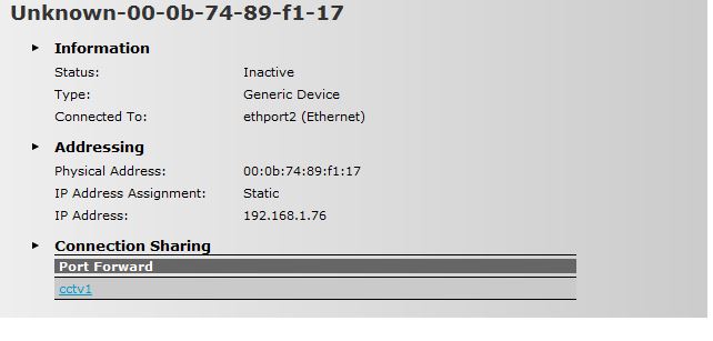

thorg Posted June 20, 2014 Author Share Posted June 20, 2014 hey Im on site, I moved dvr ip to DMZ and still no luck. Customer has static IP. The shot screen: http://i.imgur.com/xk0fTKj.jpg Router found dvr, but I cannot ping it within LAN. "Destination host unreachable" Link to comment https://www.thesecurityinstaller.co.uk/community/topic/36871-talk-talk-router-and-cctv-doesnt-work/page/3/#findComment-386098 Share on other sites More sharing options...
thorg Posted June 20, 2014 Author Share Posted June 20, 2014 I change setting in DVR to obtain Ip through DHCP, DVR got new IP from router, but I cannot ping it, I moved it to DMZ, it still does not work. I never saw so shi*** router Link to comment https://www.thesecurityinstaller.co.uk/community/topic/36871-talk-talk-router-and-cctv-doesnt-work/page/3/#findComment-386099 Share on other sites More sharing options...
Lwillis Posted June 20, 2014 Share Posted June 20, 2014 Its not the router it just how you've set it up. Assign the DVR a device name and then re do the DMZ Link to comment https://www.thesecurityinstaller.co.uk/community/topic/36871-talk-talk-router-and-cctv-doesnt-work/page/3/#findComment-386100 Share on other sites More sharing options...
thorg Posted June 20, 2014 Author Share Posted June 20, 2014 I cannot change DVR name in menu. It is Device ID, I can see it on DVR but is not displayed in router menu, only unknown and MAC address No more talk talk, and technicolor routers. I will refuse to install. Link to comment https://www.thesecurityinstaller.co.uk/community/topic/36871-talk-talk-router-and-cctv-doesnt-work/page/3/#findComment-386101 Share on other sites More sharing options...

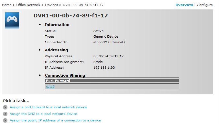

thorg Posted June 20, 2014 Author Share Posted June 20, 2014 3 hours spent on site reconfiguring all Achievement: device status from "inactive" changed to "active" but I still cannot ping the DVR and CMSView fails to connect to DVR pulling hair out of my head I really would like to kick technicolor reouter desiginer's as* for this piece of **** Link to comment https://www.thesecurityinstaller.co.uk/community/topic/36871-talk-talk-router-and-cctv-doesnt-work/page/3/#findComment-386102 Share on other sites More sharing options...

thorg Posted June 20, 2014 Author Share Posted June 20, 2014 what a rubbish!!!!! 4 h spent dvr moved to DMZ, firewall disabled, ping on WAN interface enabled, tried different ports, but I still cannot ping the DVR, and cam view software cannot connect within LAN. Last week this router was connected to Virgin Media, I could ping straight away, only enabled ports on VM router and could see picture from cameras. All done within few minutes and worked!!!! But that was Virgin Media. F*c.king talk talk and technicolor Now is: Link to comment https://www.thesecurityinstaller.co.uk/community/topic/36871-talk-talk-router-and-cctv-doesnt-work/page/3/#findComment-386104 Share on other sites More sharing options...
