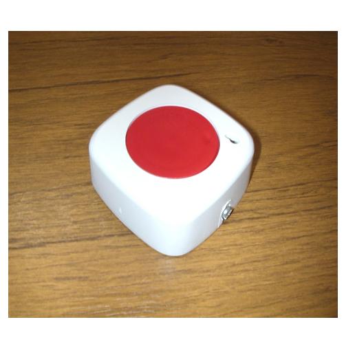

datadiffusion Posted May 1, 2014 Share Posted May 1, 2014 Got a mickey mouse job to attach two fixed calls to a wireless nursecall type system, they don't want cords and so I was thinking these via the jacks - http://www.knightplastics.com/view_item.asp?id=276 Bear in mind this isn't for elderly / dementia etc... Anyone used them before, can't imagine you have as they don't latch, but if so, are they reasonably robust? Ta! So, I've decided to take my work back underground.... to stop it falling into the wrong hands Link to comment https://www.thesecurityinstaller.co.uk/community/topic/36619-knight-pa/ Share on other sites More sharing options...
9651 Posted May 1, 2014 Share Posted May 1, 2014 love it lol Some (well most ive dabbled with) operate N/O buttons. Will this affect your job? Link to comment https://www.thesecurityinstaller.co.uk/community/topic/36619-knight-pa/#findComment-379478 Share on other sites More sharing options...
datadiffusion Posted May 1, 2014 Author Share Posted May 1, 2014 ****, hadn't thought of that... it might not be latching, but it WILL be N/C.... arsebiscuits! Ok thanks for that. Looks like its CPC, a drill, and a blank 1g plate then...! So, I've decided to take my work back underground.... to stop it falling into the wrong hands Link to comment https://www.thesecurityinstaller.co.uk/community/topic/36619-knight-pa/#findComment-379479 Share on other sites More sharing options...
9651 Posted May 1, 2014 Share Posted May 1, 2014 Most pa's ive used you can swap the magnet round to N/O (well butcher it out, then pop it back in the other holder) Link to comment https://www.thesecurityinstaller.co.uk/community/topic/36619-knight-pa/#findComment-379480 Share on other sites More sharing options...
datadiffusion Posted May 1, 2014 Author Share Posted May 1, 2014 Funny you mention that, the Texe PA is made by elmdene and was wondering what the spare magnet holder could be for! So, I've decided to take my work back underground.... to stop it falling into the wrong hands Link to comment https://www.thesecurityinstaller.co.uk/community/topic/36619-knight-pa/#findComment-379489 Share on other sites More sharing options...

sixwheeledbeast Posted May 1, 2014 Share Posted May 1, 2014 Most CQR PA's have a NC/NO jumper, if that helps. Link to comment https://www.thesecurityinstaller.co.uk/community/topic/36619-knight-pa/#findComment-379519 Share on other sites More sharing options...
